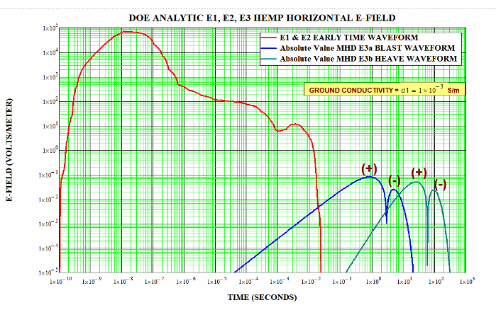

My long-time experience with MATHCAD is probably causing me problems here.
I have two different Cases construction for the E-field. Neither is correct. I have shown images of the MATHCAD construction. If you enable the orange Cases calculation, the answer is correct for E1,E2 and E3a, but not E3b. If you disable the orange calculation, you only get the correct answer for E1 and E2. The late time E3a and E3b make no sense.
HEMP E1 PLUS E2 PLUS E3a PLUS E3b.sm (149.7 KiB) downloaded 1866 time(s).
It works as expected in MATHCAD as shown in this graph. Also, MATHCAD allows for the maximum time = 1000 seconds or more. The maximum time in SMATH is limited to 100 because in the cases construction it apparently calculates all formulas for the entire time range, independent of the ranges defined inside the cases construction. This seems to be a bug to me.

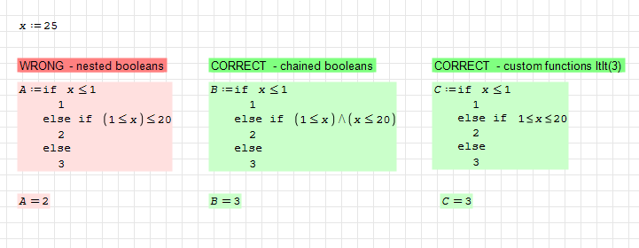

There's for sure a problem here:
(0.01≤el(t,k)) Always returns 0 or 1 depending on the actual value of el(t,k), therefore the following comparison is always 1, suppressing any subsequent condition.
I guess you were trying to check if the variable was within a range. In that case you have to chain single boolean comparisons with AND and OR operators(# and #|#). You can also use ltlt(#,#,#) from Custom Functions plugin to display it like #≤#≤#.
(0.01≤el(t,k))≤20

Davide,
Could you kindly show me how with an example?
Thanks,
Reg

#6 Posted: 2/26/2025 4:57:41 PM
Hi reg,
Yes
Here you go:
![2025-02-26 09_52_32-SMath Solver - [booleans.sm].png](/en-US/files/Download/3VcZhC/2025-02-26-09_52_32-SMath-Solver---[booleans.sm].png)
booleans.sm (6.29 KiB) downloaded 1869 time(s).
It is a common mistake. Thet's why we have parenthesis surrounding booleans, the program itself doesn't require them, but users initially miss the underlying logic.
WroteDavide,
Would it have the same issue if I had used if-else construction?
Yes
WroteDavide,
Here you go:
