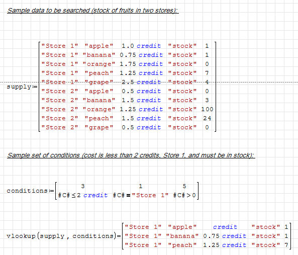

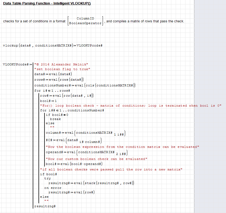

I would like to share an example of function that extracts rows from a data table based on set value in selected columns:

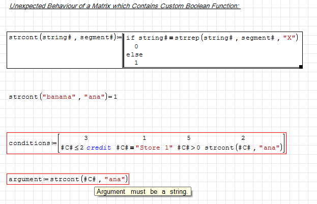

I do need help with an interesting behaviour of a matrix definition:
If an element of a defined matrix contains a user defined function with an undefined parameter it may inthrow an error similar to here (same SMath file as above):
I would expect the function with undefined parameter to return itself instead of giving an error code.

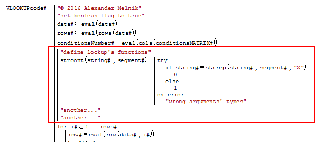

A workaround that might be useful even to avoid the use of other functions is to use a string as input in the second row, and a check in your lookup like this:
frapuano 1/3/2017 10:44:00 AM, Alexander O. Melnik 1/3/2017 8:45:00 AM

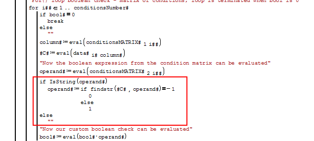

You can try with this:
strcont() is defined locally to avoid the preprocessing on the canvas
try() function is added because when you use el(...) inside the lookup function, all the elements of the condition matrix are evaluated -> you have to allow any type of input as first argument or let it fails silently (because strrep requires strings); note that if the selected element of the condition matrix is the one that contains strcon() with a wrong type as first argument, the error string will trigger an error on bool#:eval(bool#*operand#), because operand# will be a string.

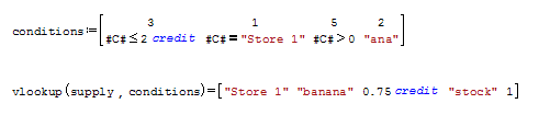

Alex,
The attached proposal is for fixed "credit".
It might be ranged via bolean.
Alex VLOOKUPdataparse.sm (33.69 KiB) downloaded 1343 time(s).

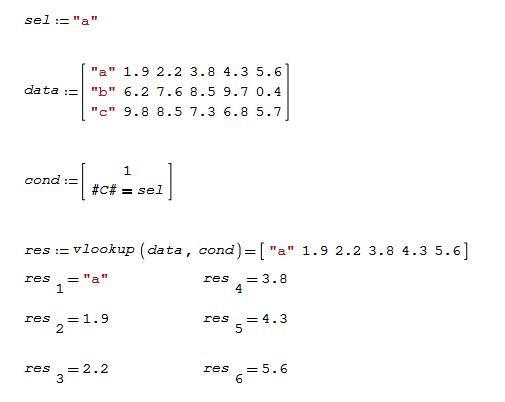

from vlookupfast.sm modification, may it be simplified for such a situation below. in case condition only use boolean 'equal to' as the same in any spreadsheet function.
