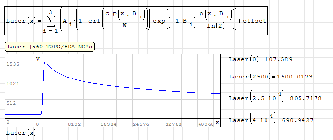

#2 Posted: 4/18/2016 2:28:13 PM
No issues I think,
the guilty is 1+erf()*exp() that should be (1+erf())*exp();
Let me know if there are other issues (erf is part of StatisticalTools)
Scrap Laser.sm (35.36 KiB) downloaded 1252 time(s).
#3 Posted: 4/18/2016 3:12:50 PM
Thanks Davide,
I just doctored it before reading you. Sorry for my distraction.

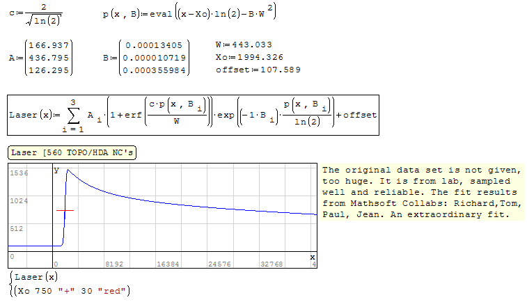

#4 Posted: 4/18/2016 3:50:25 PM
The "laser fit". Quite involved behind the scene.
