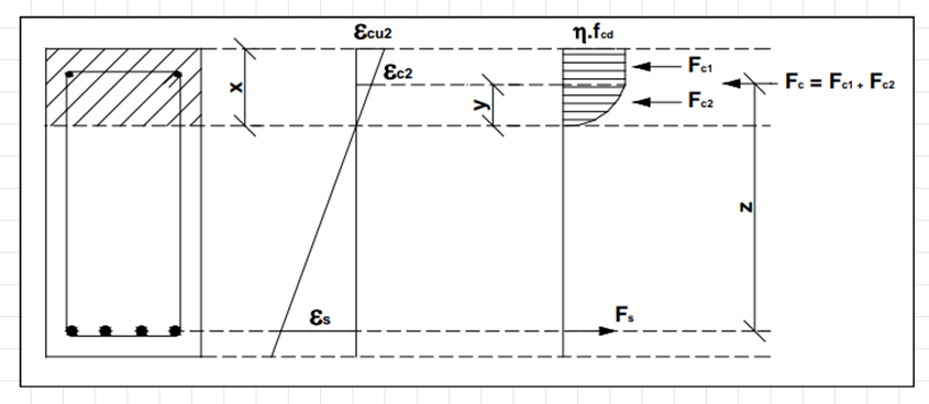

@StvMath:
As you said, you hadn't understood the Joao's problem:
It is a classical reinforced concrete bending resistance for a rectangular section:
![2024-03-18 15_48_08-SMath Solver - [Tentativa de NewtonRaphson_2 (1).sm].png](/en-US/files/Download/rDNdpr/2024-03-18-15_48_08-SMath-Solver---[Tentativa-de-NewtonRaphson_2-(1).sm].png)
With some theoretical and normative assumptions, there is only one unknown "x" and it can be obtained from the bending moments equilibrium equation. All the Joao's development is correct.
The non-linearity of the problem comes from the non-linear behavior of materials.

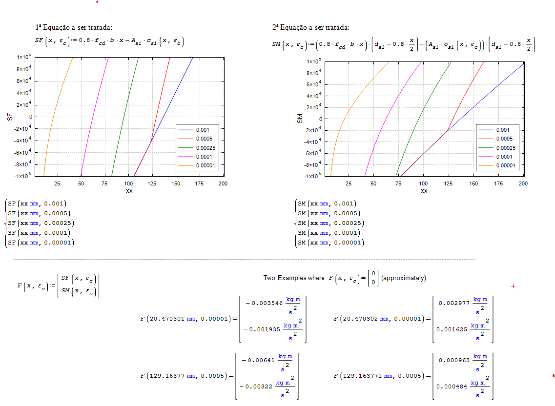

However, there is a Newton-Raphson routine trying to find the zeros of SM and SF simultaneously. My previous post suggests there are an infinite number of possibilities for this! Or am I further misunderstanding?!!!
#6 Posted: 3/18/2024 11:49:42 PM
IMHO - In fact, ultimately there is only one non linear equation to deal with a mathematical solver. The two equations belong to an intermediary phase.

The attached now runs (see the comments in red). However, your Newton-Raphson routine diverges. You will need to rethink your logic.
Tentativa de NewtonRaphson_3b.sm (215.56 KiB) downloaded 1634 time(s).
