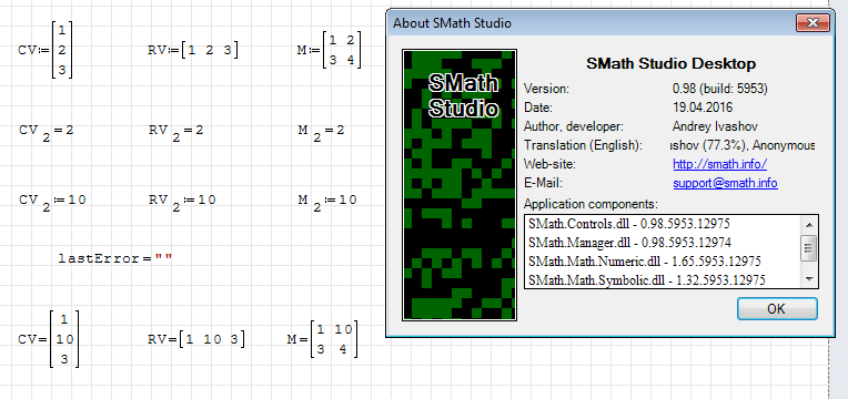

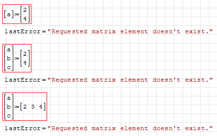

#4 Posted: 4/20/2016 1:29:53 PM
  • Added ability to assign variables/functions put into the vector/matrix;
  • Nice feature
    if possible I suggest to improve the error message when the LHS doesn't fit the RHS (something like "wrong assignment pattern")
    Andrey Ivashov 4/20/2016 6:42:00 PM

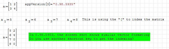

    #5 Posted: 4/20/2016 2:13:00 PM
    Ruben Sidranski
    Ruben Sidranski
    17 likes in 465 posts.
    Andrey,
    a[1 and a[2 do not need the "j" variable. In your screen shot, a[3=a[1,2 in my file and a[4=a[2,2
    I've attached my fileIndex.sm (8.35 KiB) downloaded 1695 time(s).

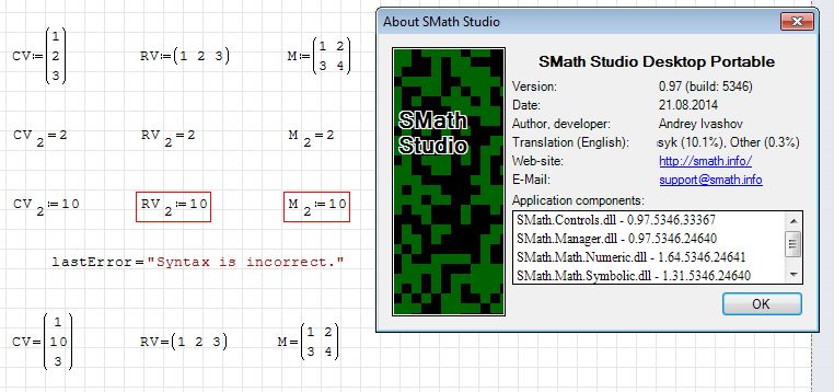

    #6 Posted: 4/20/2016 2:40:37 PM
    Not sure about the different syntax for linear indexing.
    Does the "[" do something different?
    I understand nothing in here. You can create matrix as you wish [Smath 5346]

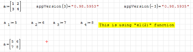

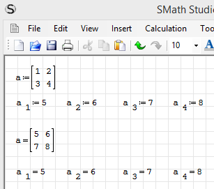

    #7 Posted: 4/20/2016 2:58:47 PM
    Linear indexing is a feature to identify an element of a matrix using a single number (base 1 index, starting from the top-left element, proceeding by columns and then by rows]
    [1 2 3 4]
    [5 6 7 8]
    [9 .....]
    Previously it was possible to use el(2) (one-index element) on matrices only in these cases:
    - to set elements in column vectors:
    - to get elements of column vectors;
    - to get elements of row vectors:
    - to get elements of matrices;
    Assigning elements in matrices or row vectors wasn't possible:
    In the meanwhile, a bug was introduced and it was possible to use el(2) in the LHS of assignments for any matrix, but in a wrong way.
    Now it is possible to use this feature to get and set elements of any matrix:
    Andrey Ivashov 4/20/2016 6:35:00 PM
    #8 Posted: 4/20/2016 4:25:50 PM
    Ruben Sidranski
    Ruben Sidranski
    So its the el(2) function!
    Not sure about the different syntax for linear indexing.Does the "[" do something different?
    That is why I was asking if Andrey was using "[" to define the matrix. I may have a use for the indexing which is why I was asking.

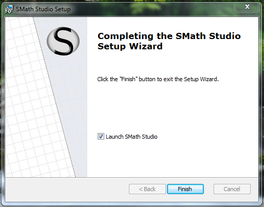

    I have had an install problem with the 0.98.xxxx series versions, installer locks up. I need to go into task manager and kill the install screen after updating or installing fresh at this window.
    If I put my mouse over this box, in Windows 7 (32 and 64), I get the mouse cursor to go to an spinning wheel. Program works fine in all installs otherwise.

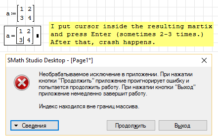

    Hurray! I finally found something to write to this thread!
    OK, seriously, I'm really excited with this recent progress, and my constant flow of bug reports isn't meant to discourage Andrey; to the contrary, I wish this projest to prosper and flourish, and to be as problem-free as possible.
    Andrey, thank you for this new build and for all your work!
    EDIT: Oh, I feel so stupid! I wrote "Enter", while I must had written "Arguments delimiter (mine is semicolon)".

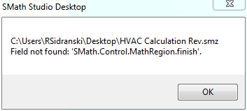

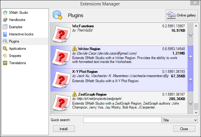

    Mike, I cannot reproduce. I just updated on of my machines to this build. I go into the resulting matrix and the red cross bar "kicks out" into white space. However, on another existing file that was working correctly, it won't open

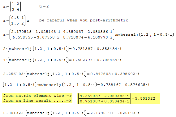

    #13 Posted: 4/20/2016 6:39:43 PM
    Hello Collabs,
    From a matrix result, you can do 3 things immediately besides
    conventional matrix algebra [rotation, transpose, rotation, inverse ...]
    1. drag/select, copy/paste element
    2. extract indexed element
    3. post process [arithmetic, function]
    Be careful on [3] versus other CAS [Matlab, Mathcad ...]

    #15 Posted: 4/20/2016 6:53:35 PM
    2,345 likes in 4,059 posts.
    You need to open Plugins tab in Extensions Manager, switch to Online Gallery and find & install all available updates there. After SMath Studio restart you will not see this error anymore.
    I'm working on the wizard which will assist users to do this semi-automatically on every SMath Studio update as it is the most common issue now.
    Davide Carpi 4/20/2016 7:06:00 PM, Mike Kaganski 4/20/2016 8:59:00 PM

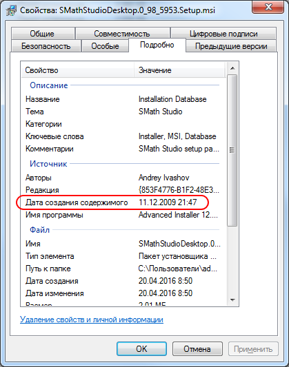

    #19 Posted: 4/28/2016 1:58:27 AM
    Mike Kaganski
    Mike Kaganski
    184 likes in 434 posts.
    Why is the content creation date in MSI is shown 11/12/2009?
    Actually, I needed this information when I noticed that this release was released twice: I have been notified by update manager and updated promptly, and haven't been notified again after that, but I started to see files that are "created with a newer SMath version" - 0.98.5953 (the same as mine), but last (fourth) part of version was greater.
