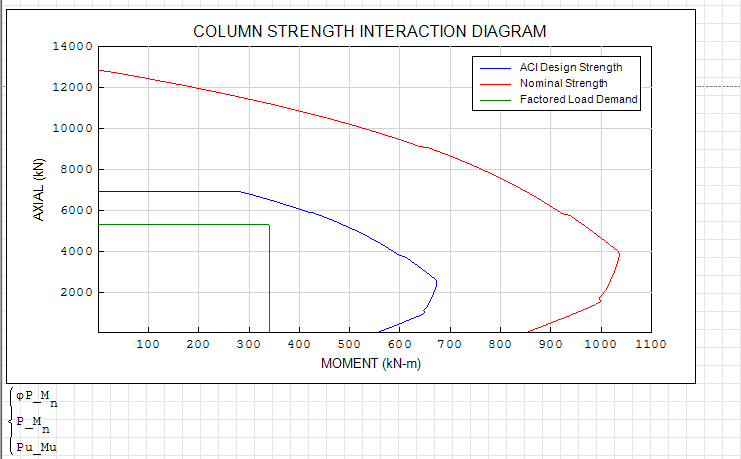

I've attached a file to generate the Compression and Bending Interaction diagram for rectangular sections, using ACI 318-11.
Any SI and US customary units work, but the results are in kN-m, which can be switched manually if you know where to look.
The rebar area and location column vectors can be made larger or smaller with no effect to the algorithm, So any number of steel layers can be used.
Future work: Expanding on this to include Biaxial Bending using the Reciprocal Load method. I had done this previously with MathCAD, and am currently working on a version for smath. I am having trouble getting it to be done without human input at certain points, but will keep working on it.
Please upload any improvements done to this file and post if any mistakes are found or if you have any suggestions.
Updated: Automatic scaling of the plot has been implemented. Also previously the section was treated as compression controlled, now the transition from compression controlled to tension controlled is taken into account.

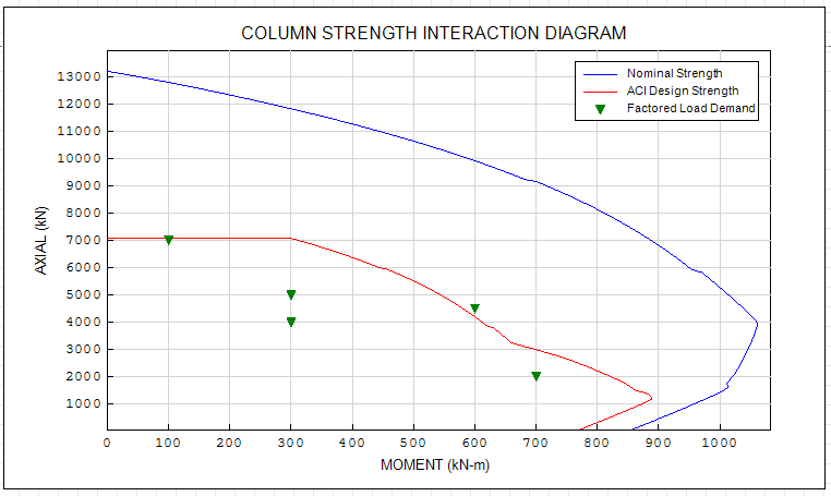

I have reproduced the diagram in Maxima Draw2D with automatic scaling (except for the x ticks, which are hardwired). Also, I parametrized the usage of units in the plot. One might even use radiobutton list regions for unit selection and having appropriate dynamic labels in the diagram.

RFreund: I'm also playing around with making it a larger function, but still along the same lines as I currently have it. Just making the functions dependent on more variables. I still want to keep it clear where each step comes from without making it so overly complicated where someone may get lost following it. This way I can add bending in the y-axis more easily. Which would lead me to my next step of incorporating the Reciprocal Load Method for checking biaxial bending and compression. Hopefully I will get around to doing that soon. I will post it once I get everything working correctly in biaxial bending.
I am wary of making a sheet that does multiple beams on the same sheet, as that takes away from the clarity of the calculations. This is another challenge of itself, scaling these things up in a way that someone else can follow what you are doing to audit your calculations. My objective is not to make a black box where things magically appear, but clear steps where other engineers can easily verify my work.
mkraska: Thanks for taking the initiative with the plot! The scaling looks great. I don't have any experience with the Maxima Draw2D and am carefully checking out your code to see what I can get out of it.

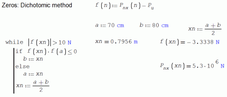

2) I want to find n value that satisfies Pnx = pu.
when I use the solve() function, an error occurs.
Is there a way to fix it?
how can find n value ?
Solvers are unstables, except maybe for al_nleqsolve. But here, and similar cases, you can implement always your own solver:

Wrotewhen Iuse the solve() function, an error occurs.Is there a way to fix it?
... more solvers in there.
Solve Dichotomy.sm (19.94 KiB) downloaded 1775 time(s).
Solve roots Newton-Raphson.sm (51.33 KiB) downloaded 1824 time(s).
Solve roots_solve RootSecant (1).sm (104.62 KiB) downloaded 1848 time(s).

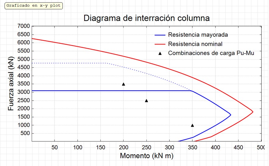

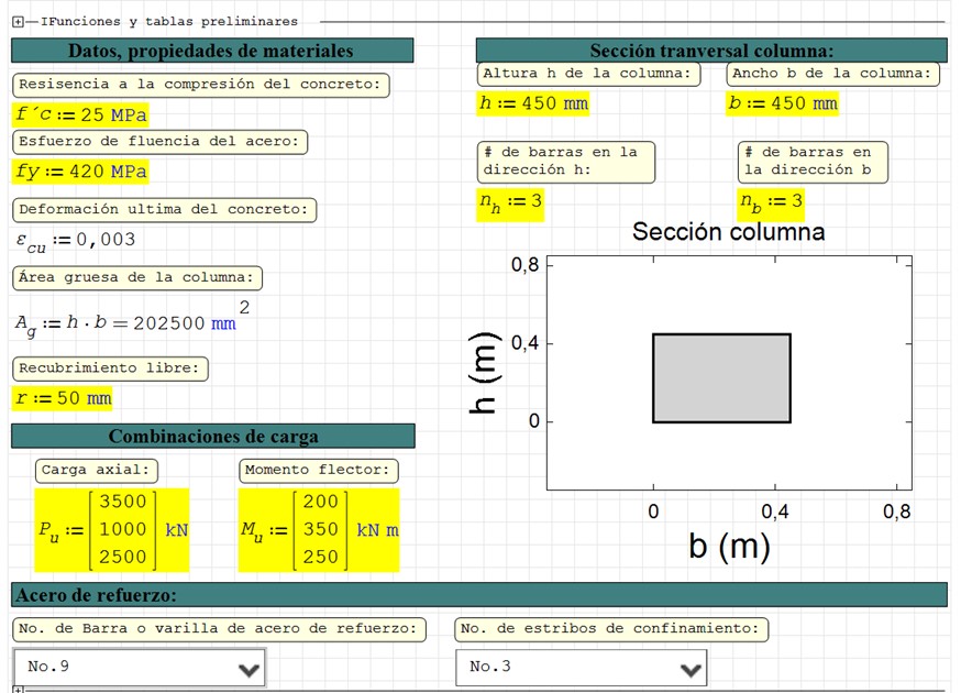

I had made my own code, but I was missing graphing, I took as a guide the code previously published here and additionally I added the graph the cross section of the column and the load combinations P-M, it would be missing to add the steel bars to that section to have a better graphical interface.
I will work to complement the code with bresler's reciprocal load method.
Diagrama de interaccion.sm (848.38 KiB) downloaded 1994 time(s).
