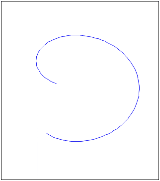

#20 Posted: 6/5/2018 12:31:28 PM
The spiral curved along a given 3d curve
Spiral1.sm (21 KiB) downloaded 1304 time(s).
Spiral4.sm (20.75 KiB) downloaded 1389 time(s).
Spiral5.sm (19.92 KiB) downloaded 1343 time(s).
