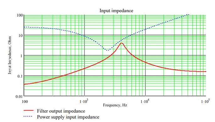

I am currently stuck on attempting to replicate page 14-15 of the TI APP note.

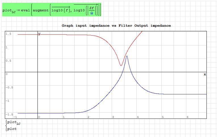

    I am struggling to understand how why my new filter impedance is not graphing
    Does it plot on your SS version ?
    When I downloaded the version that had those edits it showed that exact graph that you have posted.

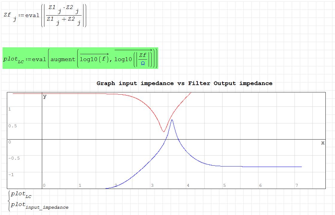

    However, whenever I leave the values as i had them without vectoring them get the expected graph, which matches the TI app note. (see picture)
    Input_Impedance_Graph

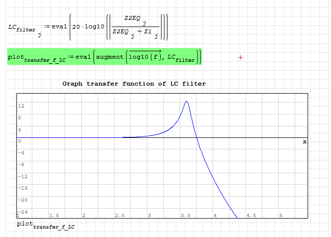

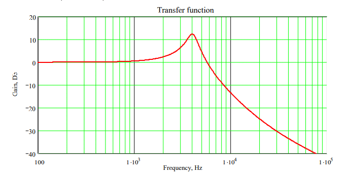

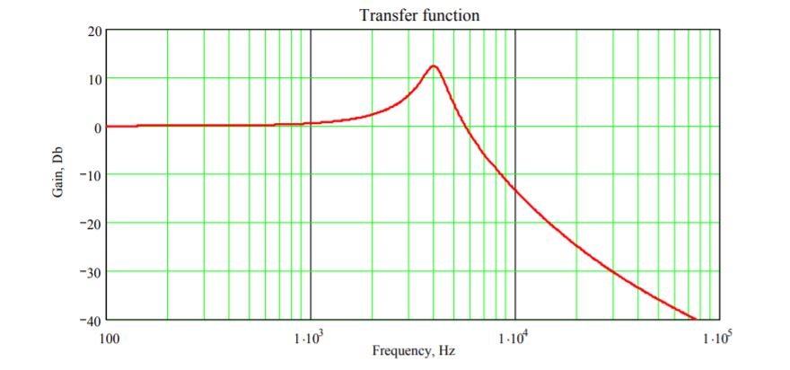

    Now what really confuses me the Transfer function plot looks so different. I input it as the App note stated however the graph seems "negated" as opposed to what I would expect.
    Questionable Transfer Function
    Proper Transfer Function

    #6 Posted: 1/21/2020 10:35:03 AM
    Any Ideas Ya'll?
    Same as the other one ... see reply.

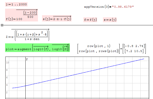

    #7 Posted: 1/22/2020 3:07:02 PM
    1,139 likes in 1,805 posts.
    Hi Carlo. You take twice log10. Just augment log10(f) and LC.filter.
    #8 Posted: 1/22/2020 6:32:49 PM
    I am still unsure as to how to what is the proper syntax on how to graph the transfer function
    1. This is not XFR [Transfer Function], simply impedance.
    2. Dimension the components wrt SI system [see TI values]
    4. More help, re-post page 1 working from this document
    5. Your version is older than SS 6179 ...
    it does not have page # associated with the cursor.
    HELPED_Input_Filter_Test_V1 ... first graph doctored NEW.sm (245.89 KiB) downloaded 1320 time(s).

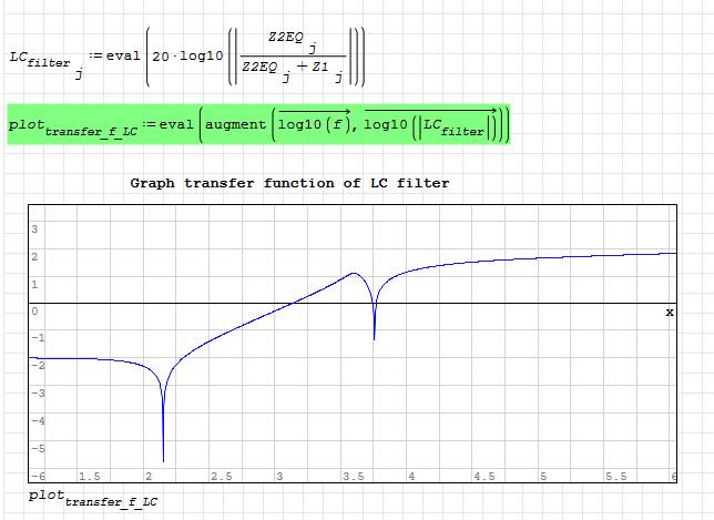

    Hi Alvaro,
    I believe that is what I did? (seriously asking here) See picture
    #10 Posted: 1/23/2020 2:09:22 AM
    Hi. Not in that plot, in the previous:
    Bad: Two logs:
    Ok: One log:
    This other have the same shape, and seems to have the same values than the mathcad plot in the TI app note. Notice that this plot is log only in the x-axis, and the y axis isn't in the log scale in the plot just because you're plotting in dB
    The last plot is log in both x and y axis. See the difference in the green lines. So, you correctly take there here log for both axis
    frapuano 1/23/2020 9:35:00 AM, bocatto 1/25/2020 3:35:00 PM

    This will be an attempt to get my graphs to look more like the following
    But hopefully without that horrible green.
