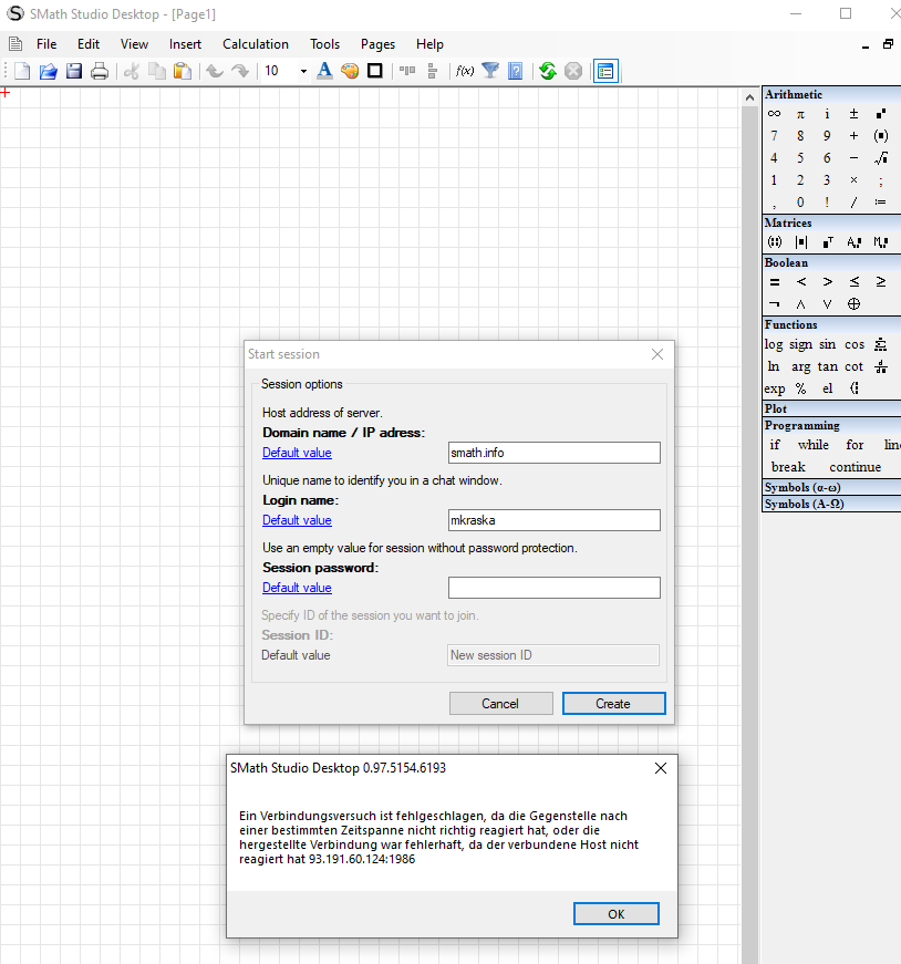

#3 Posted: 5/5/2020 1:31:34 PM
1,361 likes in 2,275 posts.
Yes, that would do the trick. However, I found that the most recent version having the feature is build 5154.
Yet, I was not able to establish a connection.
Error message essentialy saying: time-out
What is meant by the 'server'? can this be any machine running SMath Studio? Or was there a dedicated service at smath.info?
