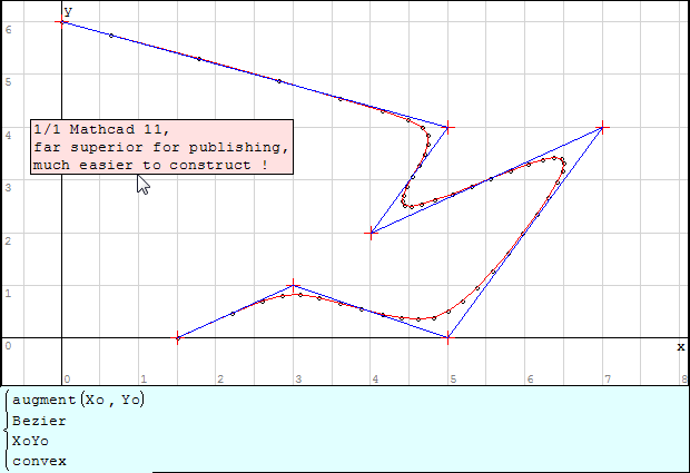

#12 Posted: 10/26/2017 10:52:56 AM
... Mathcad 11 can't do the very same, superb for publishing.
