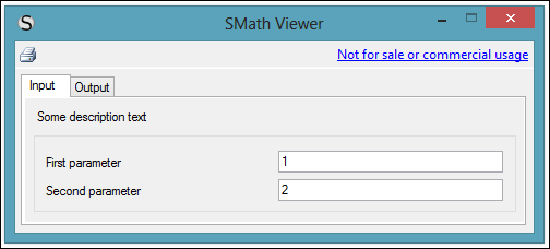

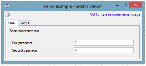

Open SMath Studio 0.96 (or newer), create some variables, formulas and text in the worksheet and open Save File dialog (File > Save as).

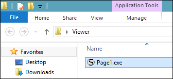

Choose SMath Viewer file type from the combobox under the file name input and press Save button.
In the chosen directory you'll see an output application which is ready to be started.
Double click on it and you will see SMath Viewer form where all the created regions shown as standard OS (Operating System) controls.

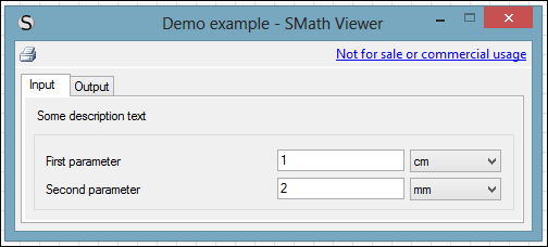

  5. Use units in your worksheet (nice units selectors will be automatically shown in output application);

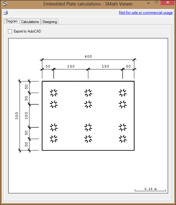

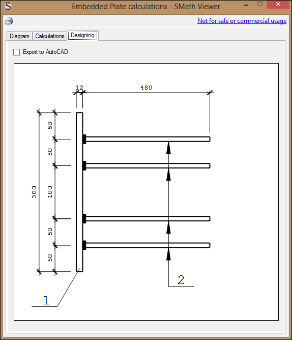

  1. EmbeddedPlate.exe (ENG/RUS) - doubleclick on the Embedded Plate on the first tab
    Show Spoiler

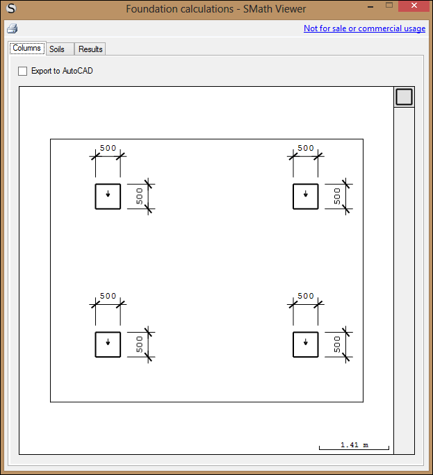

  2. TheFoundation.exe (ENG/RUS) - click/doubleclick on the columns on the first tab, add new columns on the first tab and play with soils on the second

i just have a suggestion based my experienced in engineering works:
input units are better fixed, not display as selection box in EXE files, because every engineer using consistent units in entire calculation (SI, MKS, US) if required this is an easy step to re-create sheet using different units (US version or SI version)

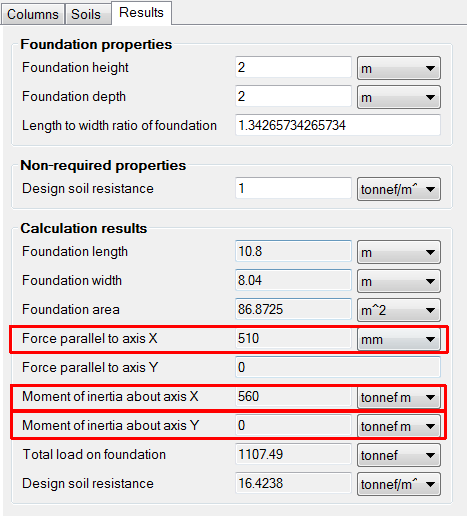

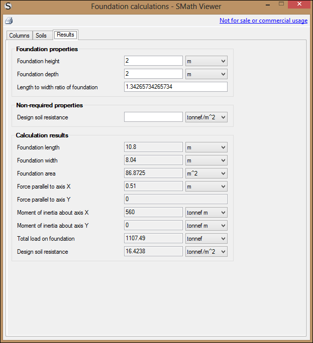

I am not from civil engng, however, it seams to be something incorrect in the TheFoundation.exe:
  1. Units for Force parallel to axis cannot be m or mm, rather Newtons
  2. Similarly, units for moment of inertia are (length)^4 (if the second moment is considered)
What about a unit configuration tool for SMath Viewer ?
The author of a smath sheet viewer could change the whole set of units as at present, and then save that configuration as different presets (US, SI..or any name he wants to call them)
There would be an option to allow users to switch only between these presets (password required to unblock this units view)

Thank you, IVR.
Example applications updated (generated using SMath Studio 0.96.4884).
  • Multi-languages feature enabled;
  • Executables size reduced;
  • TheFoundation application corrected.

The EmbeddedPlate might need a similar correction. Moment of inertia is of dimension length^4 (area times squared distance). Btw, how can I allow the user to switch between e.g. mm^4, cm^4 or inch^4?

I have also noted the problem with units changing in moment of inertia. It is, however, mostly academic problem. In practice, engineers are forced to use commonly accepted set of units. For example, stress in structures in SI-based countries is always in MPa.

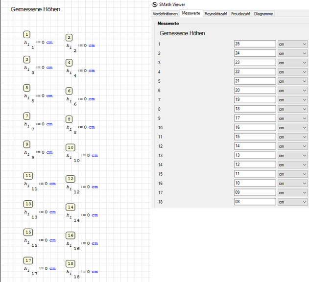

#19 Posted: 6/12/2019 11:33:36 AM
Gowand Gravi
Gowand Gravi
0 likes in 22 posts.

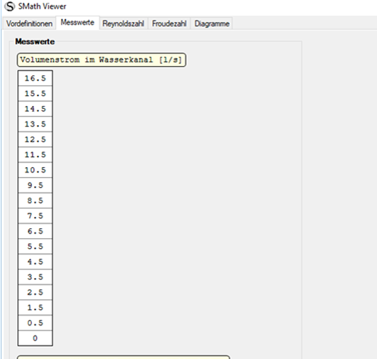

Hello there,
it seems that there is no possibility to use changeable vectors or matrices instead of single variables.
It is only possible to put vectors and matrices into a table and show the values in SMath Viewer without the possibility to change them.
Is there any possibility to use changeable vectors?
#20 Posted: 6/12/2019 12:02:58 PM
Gowand Gravi
Gowand Gravi
I found a way.
But it takes time depending on how many vectors you use.
I defined the single element indexes and gave them a name.
