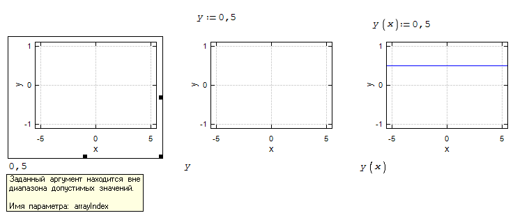

SMath Studio version: 0.99.7808 and previous stable release.
OS: Windows XP, Windows 7.
The plug-ins X-Y Plot and ZedGraph do not plot constant values.
Pop-up error message:
"The specified argument is outside the range of valid values.
Parameter Name: arrayIndex"
Constant value do not plotted in both cases:
as a number or as a variable name.
The only way to plot it is to define constant function y(x):=const
and then plot the y(x).
In the earlier releases of SMath Studio both plug-ins worked similar to the standard 2D plot.
Example of error
Вячеслав Мезенцев 5/24/2021 5:18:00 AM, Andrey Ivashov 5/24/2021 5:49:00 AM

#3 Posted: 5/24/2021 8:47:00 AM
2,335 likes in 4,031 posts.
It is not about a version, but about the settings.
Issue is reproduced and will be fixed asap.
#4 Posted: 5/24/2021 11:29:26 AM
Fixed. Fix will be a part of the next release.
