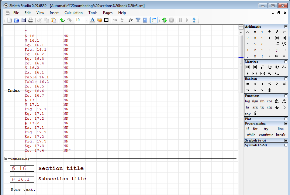

You can display the index at the begin of the document if you assign it to an absolute variable at the end (those variables starting with a tilde ~)
On german keyboards, the tilde has to be copied from a text region as it is catched as a hotkey for boolean = in math regions).
BTW, why don't you use formatted labels?

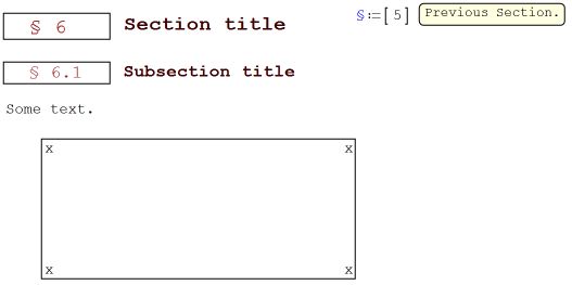

Hi Martin. Thanks for the update about global variables. I don't use formated labels because I want only to show how get automatic numbering into several SMath documents with native SMath tools. Without any doubt with formated labels it will looks great.

The formated label version.
