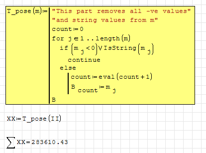

Dear All,
I am a civil engineer, specialized in water resources engineering.
My aim is to analyze 30 years of daily stream flow data in an Excel table with about 300 rows x 31 columns.
The data table contains negative values and strings which I have to discard first.
Then I want to create a column vector of data for further analysis.
The Smath program shown below gives the result, but takes a long time (about 50 seconds- see image).
As I build up the program for further analysis, the time grows up to even 5 minutes or more.
However, my Mathcad 15 program yields the result almost immediately.
Can anyone help to resolve this please? Thanks in advance.

Hello ndtma
I attach my proposal (approx. 25s on my notebook). The first part takes advantage from how are built matrices in SMath. The slower part is the 2nd (as for now I don't have ideas on how to improve this part).
[edit] please note that the first part is not strictly required, anyway seems to me (?) that there's a small speed improvement using a vector instead of the linear indexing on the matrix

12s average (not immediate, however faster than the previous solution)
