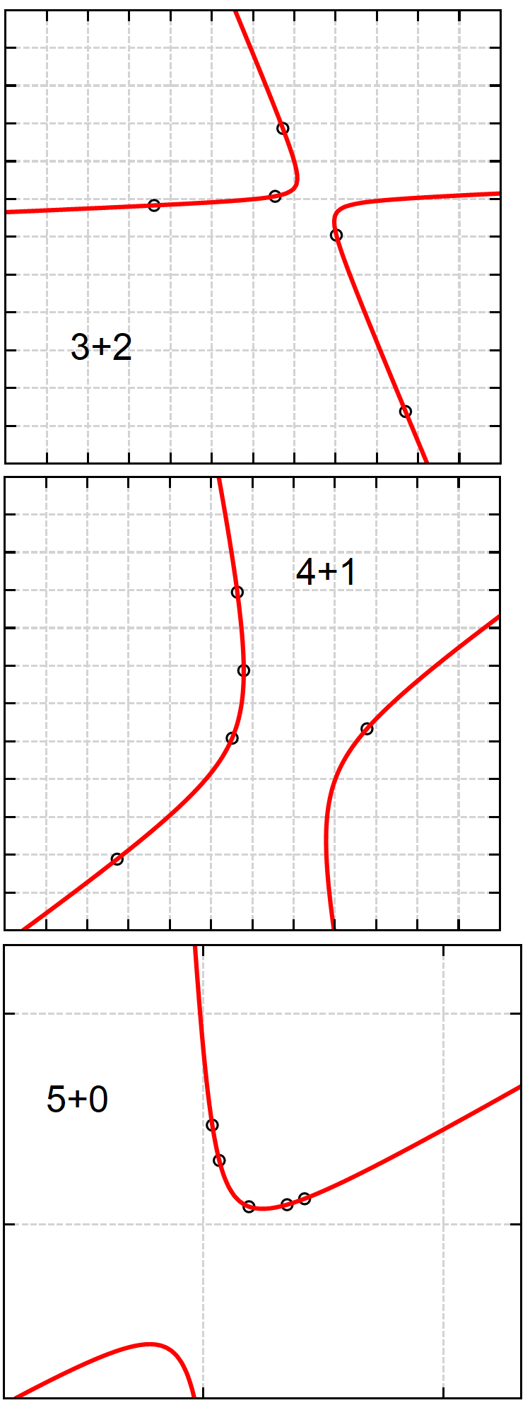

I draw a curve of the second order through 5 points. I can count how many times I get a hyperbola and how many times I get an ellipse. And what is the best way to calculate how many times you get hyperboles like 3 + 2, 4 + 1 and 5 + 0?

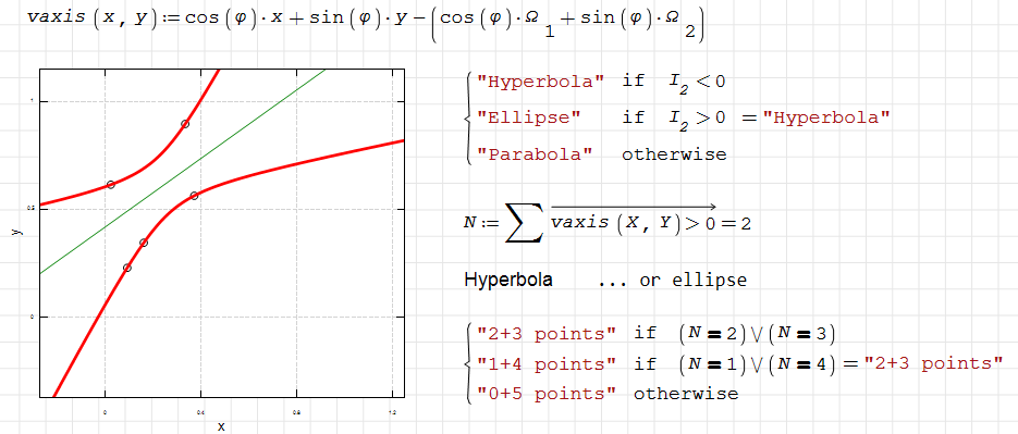

Hi Valery. One way is counting how many points are in each half-plane given by the vertical axis of the hyperbola. I can't upload files, I don't know why. This link is for a SMath live file, which do not work because it have plugins, but you can download it from there.
https://smath.com/en-US/cloud/worksheet/FNrErsL6

I took a different approach from Alvaro to counting the points (mine is somewhat more long-winded).
I rotated the points and hyperbola so the separator is either vertical or horizontal.
