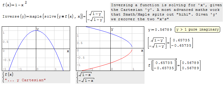

#4 Posted: 7/16/2019 9:08:32 AM
Wroteİs it possible to find max value of function.
The derivative method is just a quick lazy approach for convenience.
Derivative operator is symbolic, thus won't work for spline interpolation.
The min/max general method is the Golden Ratio.
You are confused with your next question "inverse"
An InverseFunction is a function that solve the given f(x)
... in preparation
Visit Golden ration posted next few minutes
Cheers.
#5 Posted: 7/16/2019 9:32:39 AM
Wroteİs it possible to find inverse of max value
For example f(5)=2 ise inverse of 2 equals 5
... Sorry: don't understand your maths in there.
1. Understand InverseFunction
2. ISA altitude as superb application [won't find in Web]
Solve Inverse Symbolic Suite.sm (93.66 KiB) downloaded 1270 time(s).
Inst_ISA [Landing altitude PDF].sm (305.35 KiB) downloaded 1091 time(s).

#7 Posted: 7/16/2019 10:33:16 PM
Revisit your example. The mechanics of Inversing a function is intuitive.
However the maths under the hood belongs to few advanced CAS [Maple World top].
Mathematica will do same, most of the times of different presentation.
Before you do anything with a function => graph.
Please, do not hesitate for more.
