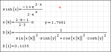

Thank you for figuring it out! This is a bug of sinh(..) function. I will fix it of cause, but for now I can suggest a solution: you need to override sinh(x) function on top of the page. Here is the screen:
Sorry for this error

Using (e^y +/- e^-y)/2 gives the true result. Just thought I'd let you know.
