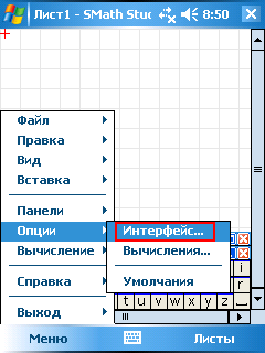

Hi. The default language is russian. How to change it to another language ?
#2 Posted: 12/30/2008 6:04:04 PM
2,343 likes in 4,047 posts.
Hi. The default language is Russian. How to change it to another language ?
Hello.

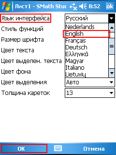

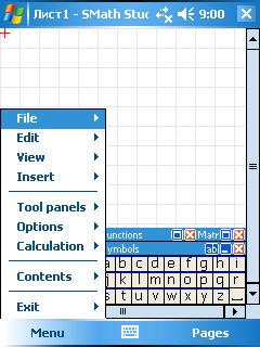

Hmm. First time SMath Studio starts it chooses the interface language according to your Operating System settings. So, it's a little bit strange...
But, if it happens, than use following screens:
This screens are from new beta-version and if you use old 0.50.0-0.50.4 version I advise you to install the latest here.
