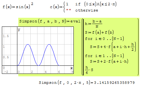

#3 Posted: 5/21/2019 11:28:25 PM
... you can have it Omer Simpson
Integrate Compendium_24 MCDadaptive Read EDU.sm (63.96 KiB) downloaded 1281 time(s).
