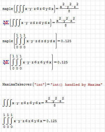

Hello, is it yet possible to do double or triple numeric integrals? Is see much older posts indicating it is not possible, but wondered if in the intervening 10+ years, this has been developed. I was not able to find a plugin that address this. Attached is an example of the type of calculation I am trying to do:

#2 Posted: 10/1/2024 9:23:50 AM
Hi Jon. I'm pretty sure that in some previous version SMath can deal with multiple integrals. Now you can use maple or maxima plugins.

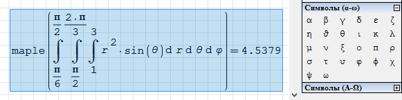

#3 Posted: 10/10/2024 9:24:12 PM
Do you know why Maple fails in this example? The Maxima result is correct.
#4 Posted: 10/10/2024 9:35:07 PM
Try another symbol for phi (φ).
The thing is that Maple 6 doesn't support Unicode symbols. That is why only one type of phi symbol was chosen.
They say there is such a symbol. I'll see why I couldn't use it.

#5 Posted: 10/10/2024 10:10:05 PM
MapleTools plugin has been updated and is available in the extension manager.
So now you can use ϑ (vartheta) and ϕ (varphi).
