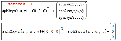

#1 Posted: 6/16/2017 7:55:37 AM
Probably just informative.
As it looks Smath does not comply to this rule.
It may just be a Mathcad/Mathsoft rule ?

Hi Jean,
this is because the function sph2xyx might returns a scalar as well as a matrix. Vectorize should do the job, though.
