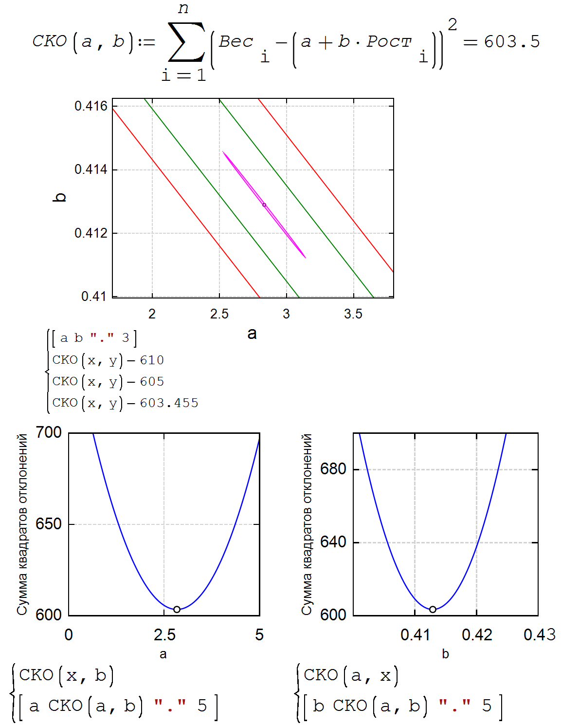

I have two 2D plots, but not one 3D plot with the minimum point.
Help please!
6-1-Mister-Class.sm (21.77 KiB) downloaded 1388 time(s).

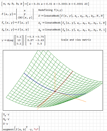

Hi Valery. This is a way.
6-1-Mister-Class.sm (27.39 KiB) downloaded 1374 time(s).

Hi. Choosing CKO as z and using small ranges.
6-1-Mister-Class 3D.sm (41.91 KiB) downloaded 1389 time(s).
