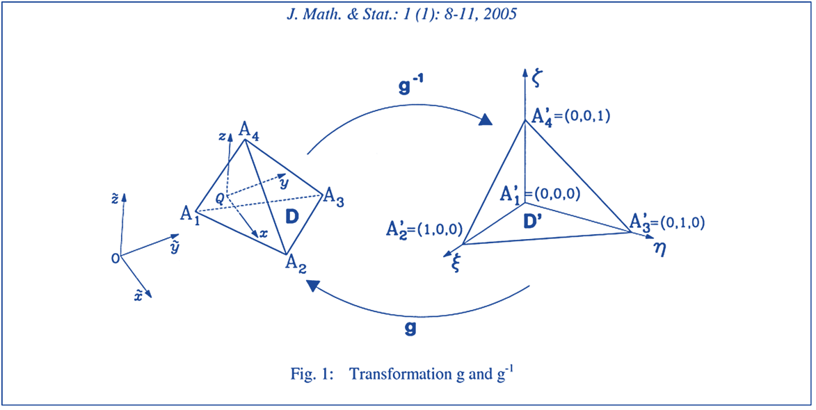

Hello Everybody,
I found a very interesting paper about the explicit formulas for the inertia tensor of a tetrahedron, defined with the 3 coordinates of its 4 vertices:
https://thescipub.com/abstract/jmssp.2005.8.11
The symbolic integration process for the obtention of the inertia tensor’s terms was conducted in the “F. Tonon’s” paper by using the “Mathematica” program.
I used the “SMath’ Maxima plugin” for the symbolic integrations.
My results gave identical numerical results as that of the “F. Tonon’s” example.
My formulas are available in an appended SMath file:
### Tetrahedron's Inertia Tensor - Ioan 2026.sm (3.04 MiB) downloaded 1037 time(s).
I included some additional results obtained by using “Maxima” plugin, for “Eigenvalues and Eigenvectors”. Even if the “Maxima” plugin allows the obtention of symbolic results, the complexity of these formulas lets me prefer the numerical application.
I’m interested in having opinions of those familiar with this category of problems by looking in two directions:
Best Regards,
Ioan

Once you have the inertia tensor of a tetrahedron in arbitrary coordinates, then you can compute the inertia of any body that has a surface triangulation (as available in the STL file format) using tetrahedra generated from a surface triangle and some reference point. The orientation of the triangles matters.
I assume that this approach is used in CAD software to compute the mass properties of 3D bodies.

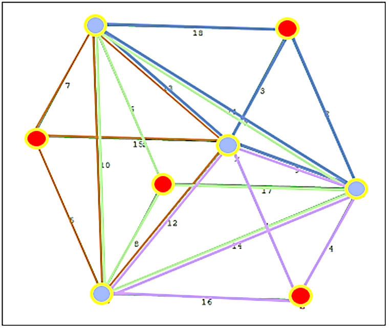

Thank you for the interestings suggestion.
Of course, a 3D space object can be decomposed by using tetrahedrons.
However, 2D figured do not need imperatively to use triangles for making plan figures.
I thought on another nice issues for using tetrahedrons, based on the decomposition of an irregular hexahedron into four linked tetrahedrons as here:
In such way we can create a sort of super element, with an unique output insted of four and also with only 24 input coordinates instead of 6*4*3=72.
The hexahedron finite element is often prefered.

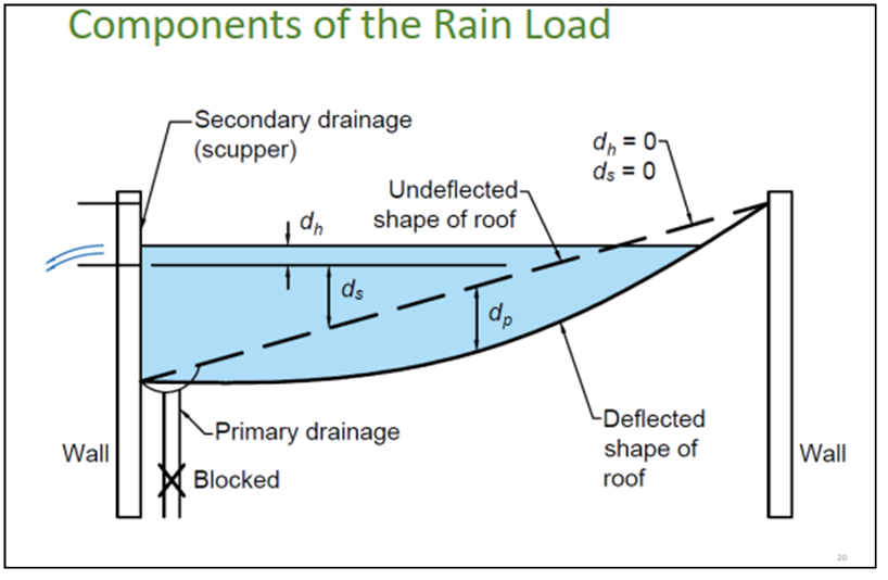

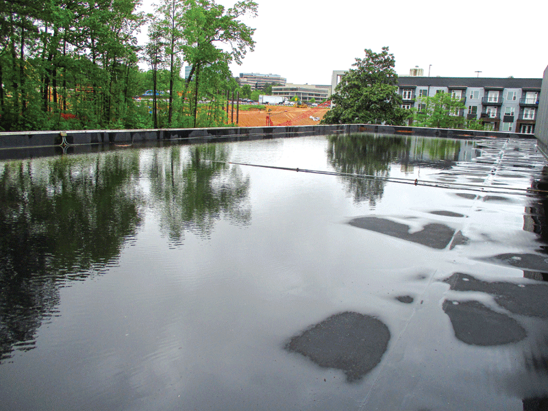

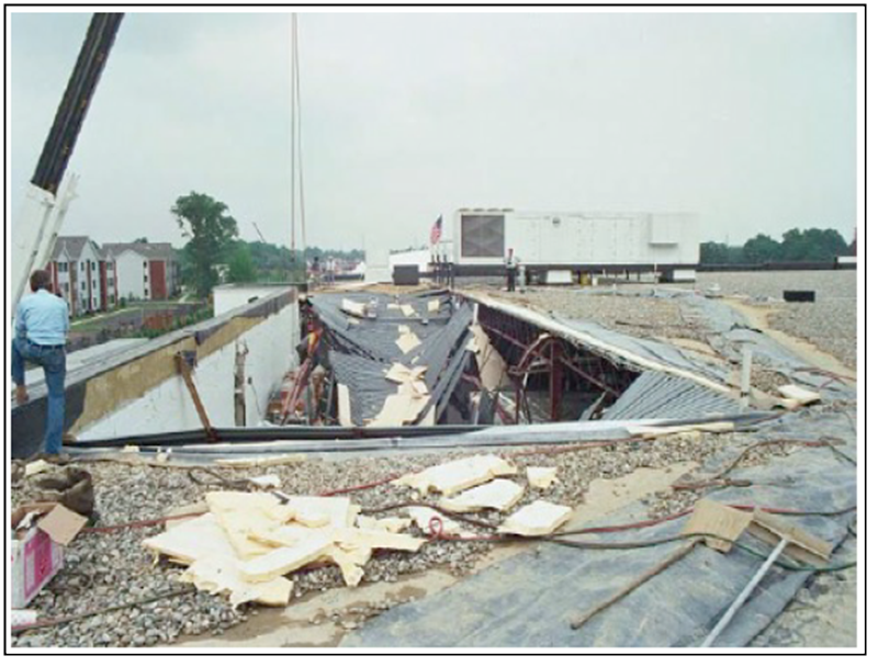

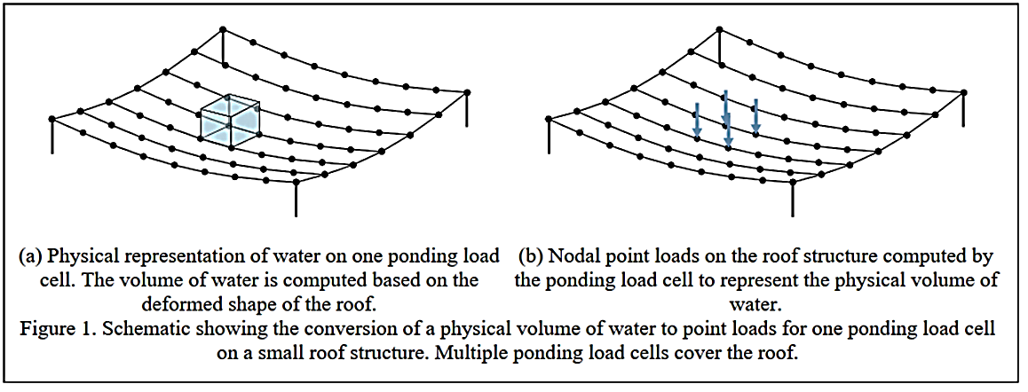

My starting point on this topic was not mainly the Finite Elements, but a problem about the analysis of the "Water ponding on contructions roofs". This problem contains some geometrical nonlinear aspects.
The geometrical properties of 3D objects are widely used also in many other fields ...
