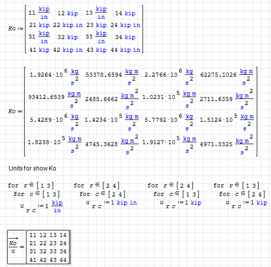

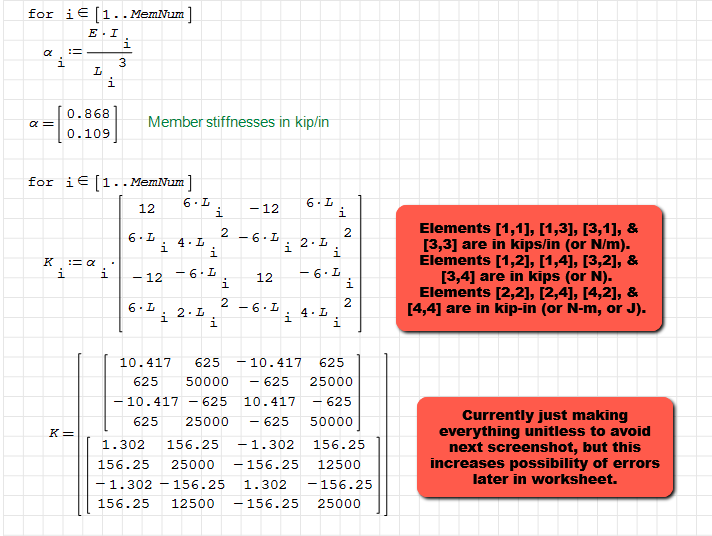

I've been using SMath for several years now, and I generally like it. But one shortcoming compared to Mathcad has always been the units for the US, even though consistent and automatic unit conversion is SMath's most helpful ability compared to something like Excel for engineering calcs. Most of the time, I can just go through the extra steps of typing in the units I actually want every time SMath displays the results in metric units. But I can't do that in matrices. If everything in the matrix is the same unit, then I can type in my USCS units outside the matrix and everythign is good. But sometimes I have mixed units like with stiffness matrices, and I end up with results like below with no way to force them to display correctly. Even these are the result of an extensive workaround earlier in the worksheet where I basically made all my inputs dimensionless and had to keep track of units manually, as some of my stiffness matrices will have various elements in kips, kips/in, and kip-inches, all in the same matrix and not segregated by row or column. I've tried using the "Imperial" option in the user settings file several times over the years, but that is worse than leaving it metric and manually changing every unit in every formula. I've tried editing the Units.xml file, but I'm not sure how to go about that. Is there any guidance on how to edit that? Long story short, I would really request a better ability to define default units, especially when dealing with matrices. They need to be able to have certain units on a per-element basis.

... If everything in the matrix is the same unit, then I can type in my USCS units outside the matrix and everythign is good. But sometimes I have mixed units ...
Hi Jason. This is a workaround. You can't show a column vector with mixed units, but a row vector.
row_vec_mixed_units.sm (3.77 KiB) downloaded 1832 time(s).
Oscar Campo 10/31/2022 12:10:00 AM, sergio 10/31/2022 5:31:00 AM

Martin, I agree. I would rather not have to edit Units.xml, but I'm not sure how else to accomplish it besides preventing SMath from even knowing those other units exist. Other than occasionally getting into some Eurocode calcs for structural mass timber connections, 99% of my work is in the US where metric is never an issue, and I'm basically the only one at my office (or in my grad school class, which is actually where I'm getting more heavily into the matrices now) that uses SMath or any of the calcs I develop from it. Office colleagues use Excel, and classmates use Mathcad. So a custom xml file might not be a big deal for me. I would like to see some more control of units moved into the program UI where you don't have to exit the program and edit settings files just to switch the default from Metric to Imperial or vice versa. But then the switch to Imperial has never really helped me because it always wants to use units I don't want, so I end up retyping all my units just as much as I did when it was set to metric, so I normally just leave it metric in the User Settings file.
Alvaro, thanks for the workaround suggestion. I don't think it will help, but let me add some more context. These stiffness matrices are (currently) 4x4 matrices with bending stiffnesses in 2 positions of each column and rotational stiffnesses in the other two positions. Previously, for truss stiffness matrix work, I was able to just apply kips/in outside the matrix because they were all axial stiffness terms, but now I have more degrees of freedom and more terms, and different units among the terms. This week, my class is proceeding to frames that will add more degrees of freedom and more variety of units among the different terms. See below for an example where I made everything unitless based on my input being in a specific input (length in inches, etc) so that my numerical values are correct in all terms, and what the same matrix looked like before when I had units assigned. I would like to see the units assigned and carried through if possible, because it is extra work to make sure I apply the correct units to my results at the end based on which elements were used from the matrix (e.g. is the value in my final system matrix based on the bending or axial stiffness value? One or the other might get canceled out because of boundary conditions, and that elimination happens in subsequent steps.) So while the row vector may be a workaround for the smaller vectors I'd initially shown in my first post, the matrices those derive from are bigger and more complicated and are actually the root problem, and I don't think that would be an option for those. But thank you for the suggestion!

Hi Jason. This is a workaround for show mixed units in a matrix.
matrix_mixed_units.sm (18.34 KiB) downloaded 1836 time(s).

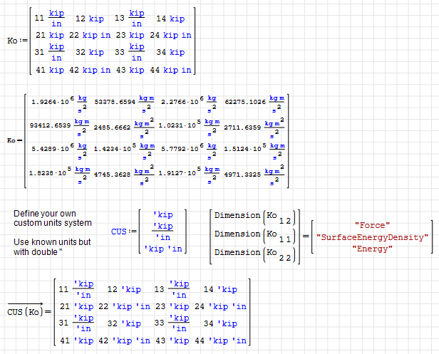

Another way (always there is one more). Using Dimension utility, from this post.
dimensions v2.sm (68.59 KiB) downloaded 1800 time(s).
Oscar Campo 10/31/2022 10:49:00 PM, Mark R Harris 11/5/2022 5:26:00 PM

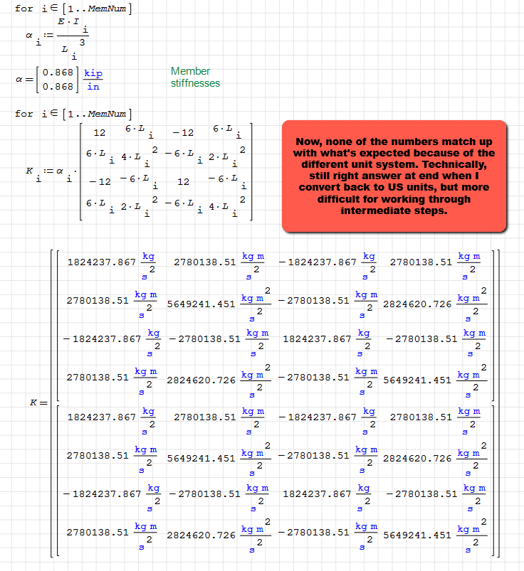

...But sometimes I have mixed units like with stiffness matrices, and I end up with results like below with no way to force them to display correctly...

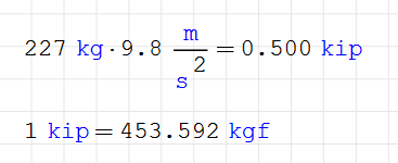

    Quote

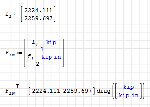

    Notice that Jason does not want ... but rather to have 2224.111N reported as 0.5 kip.
    Sorry Kenny & Jason, I suspect that I'm not understanding this issue fully. SMath appears to be handling the conversions and units display correctly:

    Thank you for the excellent summary Kenny, greatly appreciated.
    If I have this right, it sounds like there is agreement that the following steps are not at issue:
      1. User declares their input variable in whatever units in their preferred units (an unavoidable pre-requisite).
      2. SMath calculates the results, using SI units internally, and the results are correct in their SI units.
      3. The SMath conversion to imperial units, as chosen, are correct (noting the bug/limitation described in SS-2286).
      4. The display of significant figures (incl training zeros) is correct.
    Regarding the symbolic representation of 0.52 kip (0.52 should be represented as 13/25): this is likely is correct, but likely arises from the finite resolution of the unit-conversion steps (call it ‘JACOIU’ for brevity).
    Likewise, to me it sounds like your Option 4 would be best. Continuing the summary theme: to work adequately some development work is needed:
      A) On a per-sheet basis: per-measurement basis (ie per-MKS calculated combination): the ability to force the displayed units of calculations.
    Agreed, it looks to me like the behavior described in SS-2286 is inconsistent with the nicely consistent behavior with SI units. So, it is likely a bug and needs to stay as an issue despite A) above nicely bypassing the issue.
