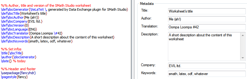

Hello Davide,
I have problems with the export XeLaTeX.
First it is highlighted exception
Proceeding is inhibited the choice of options
Proceeding is nevertheless produced a tex file
You must still add the following line in the markup to fill in XeLaTeX
\newcommand{\defeq}{\coloneq} % SMath 'define equal' symbol
PS some addition function is not implemented, however, the qualitative result of the prints obtained is much higher than that of normal export pdf. I would hate a little if this project was abandoned
[albumimg]1437[/albumimg]

I see, seems something related to multithreading vs Forms. I have to ask Andrey, but I think that I have to remove the dialog from the save flow.
The project is not abandoned, but you know, there are a lot of plugins and I have to find a little bit of time for each one. I'll implement the missing functions ASAP.

PLUGIN UPDATED SMath Studio 0.97.5346 and later
- SS 0.98: fixed crash on save due to the Forms vs MTA;
- ODT, TEX files: added Command Prompt flags (see documentation in 1st post);
- ODT, TEX files: added more functions (vectorize, Floor, Ceil, at, cases, ternary booleans, absolute-definition's functions), fixed glitches in functions' names in ODT files, minor fixes & improvements;
- TEX files: all worksheet's metadata are now stored in the \doc***** variables;

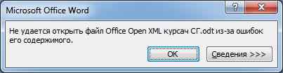

I want the formula looks like this Clipboard01 - kopija.jpg.
But after i saved my file in .odt ( ODF text doc.) wordpad told me that there is content who was incorrectly
displayed.When i tried to open file in Word (2007 version) it cant be open beacuse Clipboard01.jpg
Translation: "Cant open file Office Open XML because of errors in his content"
displayed.When i tried to open file in Word (2007 version) it cant be open beacuse ...
Это не плагин "не делает того, что заявлено", а хреново работает MS Office. То, что WordPad не может его прочитать - так он вообще мало что может. А вот 2007 версия офиса, в которой появилась впервые поддержка ODF, получила очень плохую репутацию за некорректную поддержку - Майкрософт тогда вообще обвинили, что они саботируют ODF такой поддержкой.
Вот файл, открытый MS Word 2013 и пересохранённый в docx: kursach SG.docx (112.71 KiB) downloaded 850 time(s).

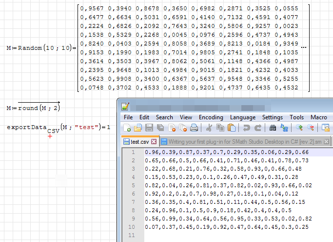

Hello there,
Is there a method for using round() with exportDataCSV?
Perhaps I need to loop through the multi dimensional array and operate on each entry using round(), ahead of using exportDataCSV.
Please point me in the right direction for a robust method.
Tim
#156 Posted: 10/16/2017 12:38:09 PM
You can use a loop or vectorize() over the round function

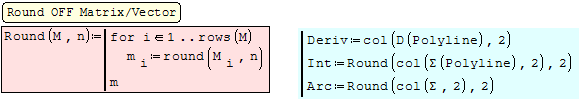

Utilities Matrix roundup_n.sm (24.9 KiB) downloaded 1545 time(s).
#159 Posted: 10/17/2017 4:40:48 PM
In the last Hermite polyline, it does not understand
vectorising roun(col,n) over specific col ... done otherwise.
