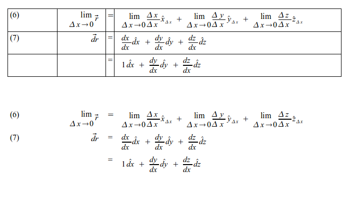

#44 Posted: 1/24/2013 5:21:05 PM
Rising Eagle
Rising Eagle
15 likes in 23 posts.
P.S. the MS Word compatibility of ODT documents containing formulas was reached; with regard to the alignments of the functions I haven't found a way to force MS Word to do it.
Websurfer,
Very impressed with your projects.
Don't know if this is relevant or how sophisticated you want to be about reformatting stuff, but this thought may be of use. MS word has a facility (as does LO) called tables. When tables are created, each area in the grid is like a mini-page on its own and can be formatted independently of all the others. To align equations, make a 4 column table, put the equals sign (=) in the third column, and narrow the column width to the minimum needed to leave the equals sign visible. Then place equation numbers in the first column, and the LHS and RHS expressions in the second and far right columns. Align the LHS to the right and the RHS to the left. All equals signs and RHS expressions to follow on subsequent lines will be aligned properly.
In the LO file below, tables are used with mathml formula objects in the second and far right columns. Text is used in the first and third columns. This table formatting works in MS office as well. I adjusted the font size of the equals sign until it looked right.
Btw, how does one make math expressions (is it latex?) in these forum posts?

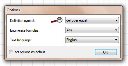

PLUGIN UPDATED
  • added "Save as... > LaTeX Text Document";
  • ODT saving:
    - ouptut ODTs now are compatible with MS word (brackets looks better than saving the file from libreoffice)
    - added options on ODT saving (Save text as images/Save formulas as images/evaluate equations)
    - "Print Area Regions" settings from "Page Setup..."
    - SMath texts on multiple lines now are shown on multiple lines even in the output file.
    - minor changes
  • ODF saving: each evaluation (input formula/symbolic/numeric) written on a different line of code;
  • Embedded languages: ENGLISH/ITALIAN/RUSSIAN

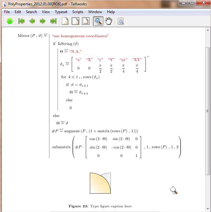

#46 Posted: 1/25/2013 5:16:29 PM
1,361 likes in 2,275 posts.
Hello w3bsurf3r,
thanks for updating the plugin. The Latex-export looks great (not yet tested, but your preview looks promising).
Just a small remark:
default export path is not defined by where the current sm file is but by the current directory. If you first launch SMath, then the current directory for the entire session regardless which files are opened afterwards is where the executable is.
As plugins need to be used with the msi-Installer version, the executable path is normally read only and example execution fails. Anyway you do not want to clutter the install dir by accidental export data.
When you just launch a sm file in the file manager, then current dir is equal to sm file dir.
If you have any chance to determine the sm file path name independently from the current dir, then I would recommend to use this and thereby be consistent to what your docs and examples say. This is would make the target dir more predictable and independent of how the file was opened. Otherwise the comments in the examples might need correction.
Martin

#49 Posted: 1/26/2013 9:48:39 AM
Hi rising eagle, It's a good idea but quite complicated to generate undefined levels of nested equations/statements (but I've done something similare for LaTeX, where tables and formulas can be mixed easily).
About formulas in forum posts look here

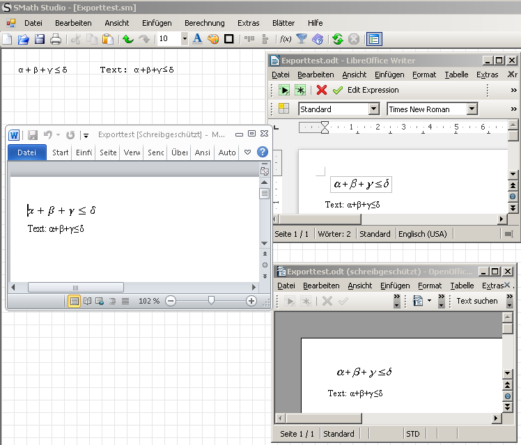

#55 Posted: 1/28/2013 4:07:00 AM
xyonx
xyonx
0 likes in 10 posts.
hi DC, thanx for updating plugins
try using plugins, save as ODF/ODT all symbols did not display (except for Pi) since it contains "i" at beginning symbol code in OOo math
and here's display result,
please consider, is this crucial for math? thx u
#56 Posted: 1/28/2013 8:32:04 AM
I cannot reproduce the problem, see image.
#57 Posted: 1/28/2013 10:13:26 AM
Thank you, I'll fix it ASAP! [DONE]

Yes, it's possible... [DONE]
- provide choices (if possible with adjustable default settings) for
-- assignment operator (:= vs def over =)
-- equation numbering (starred or unstarred equation environment)
[DONE] (can memorize settings)
