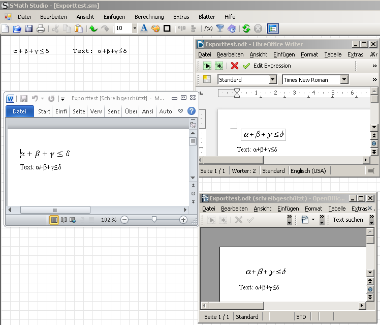

#41 Опубликовано: 19.01.2013 10:02:43
Try the attached DataExchange.dll
images now have the correct size, thank you for the bug fix. Also, direct word read in is possible (zugstab-export-1.odt). However, in this case only images and text regions are read, all math regions (formulas) are broken.
Intermediate load and save with libreoffice (zugstab-export-LO-1.odt) improves the word import, still the formatting of control structures is broken.
In general, opening both odt files with word generates error messages. If saved as docx from Libreoffice, then Word can read the file cleanly, still formatting is broken (mainly due to centering of math items)
Martin
I've found (and removed) the cause of MS word annoying message.
Any ODT Formula it's composed by two parts: the first, a MathML Markup code, and then the StarMath code (what do you see in the Formula editor as "the code" ). Both LibreOffice and OpenOffice don't require the first one, but seems that MS Word (although not explicitly) need it. Some little test that I've done to introduce the MathML code don't produce the expected result so, as for now, the MS office compatibility is limited to texts and images. [edit] The MathML code will be available ASAP.
Actually an idea could be to add an option to export ODT formulas as images; Further improvements could be added with the next OpenOffice or LibreOffice SDK.

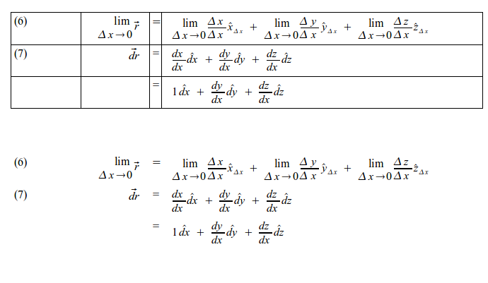

Rising Eagle
Rising Eagle
15 сообщений из 23 понравились пользователям.
P.S. the MS Word compatibility of ODT documents containing formulas was reached; with regard to the alignments of the functions I haven't found a way to force MS Word to do it.
Websurfer,
Very impressed with your projects.
Don't know if this is relevant or how sophisticated you want to be about reformatting stuff, but this thought may be of use. MS word has a facility (as does LO) called tables. When tables are created, each area in the grid is like a mini-page on its own and can be formatted independently of all the others. To align equations, make a 4 column table, put the equals sign (=) in the third column, and narrow the column width to the minimum needed to leave the equals sign visible. Then place equation numbers in the first column, and the LHS and RHS expressions in the second and far right columns. Align the LHS to the right and the RHS to the left. All equals signs and RHS expressions to follow on subsequent lines will be aligned properly.
In the LO file below, tables are used with mathml formula objects in the second and far right columns. Text is used in the first and third columns. This table formatting works in MS office as well. I adjusted the font size of the equals sign until it looked right.
Btw, how does one make math expressions (is it latex?) in these forum posts?

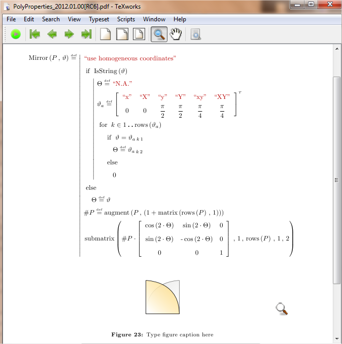

PLUGIN UPDATED
  • added "Save as... > LaTeX Text Document";
  • ODT saving:
    - ouptut ODTs now are compatible with MS word (brackets looks better than saving the file from libreoffice)
    - added options on ODT saving (Save text as images/Save formulas as images/evaluate equations)
    - "Print Area Regions" settings from "Page Setup..."
    - SMath texts on multiple lines now are shown on multiple lines even in the output file.
    - minor changes
  • ODF saving: each evaluation (input formula/symbolic/numeric) written on a different line of code;
  • Embedded languages: ENGLISH/ITALIAN/RUSSIAN
best regards,
w3b5urf3r

#46 Опубликовано: 25.01.2013 17:16:29
Hello w3bsurf3r,
thanks for updating the plugin. The Latex-export looks great (not yet tested, but your preview looks promising).
Just a small remark:
default export path is not defined by where the current sm file is but by the current directory. If you first launch SMath, then the current directory for the entire session regardless which files are opened afterwards is where the executable is.
As plugins need to be used with the msi-Installer version, the executable path is normally read only and example execution fails. Anyway you do not want to clutter the install dir by accidental export data.
When you just launch a sm file in the file manager, then current dir is equal to sm file dir.
If you have any chance to determine the sm file path name independently from the current dir, then I would recommend to use this and thereby be consistent to what your docs and examples say. This is would make the target dir more predictable and independent of how the file was opened. Otherwise the comments in the examples might need correction.
Martin
Hi rising eagle, It's a good idea but quite complicated to generate undefined levels of nested equations/statements (but I've done something similare for LaTeX, where tables and formulas can be mixed easily).

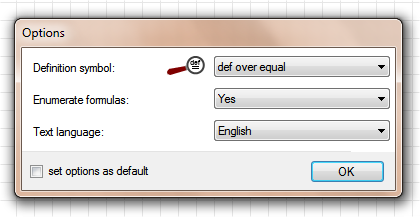

#51 Опубликовано: 27.01.2013 15:00:06
I admit that these proposals were just matter of comfort. The trade between user comfort and coding effort is of course your decision.
Perhaps, an alternative could be to have sort of template in some sensible place (somewhere in install dir or in a system user dir). The default then would be what you currently have.
I bet there is no chance to design a single template such that it works in any language environment. In my case, the german umlauts fail to compile, even if I use my input- and fontencoding from the handbook source. Perhaps there is just too much side effects and dependencies between the packages (I never used some of the ones in the latex export).
As for languages issues, my idea was to export the worksheet as a XeLaTeX document with XITS Math fonts and Linux Libertine fonts... it supports accented letters, german umlauts and cyrillic script...
That might be a good way. My exported docs compiled with xetex and had the umlauts right. With pdflatex they are lost by whatever reason. pdflatex works fine for my handbook, which is full of umlauts. But never mind, I'll just add "use xelatex to compile latex export" to the survival rules.
Martin

- provide choices (if possible with adjustable default settings) for
-- assignment operator (:= vs def over =)
-- equation numbering (starred or unstarred equation environment)
[DONE] (can memorize settings)
