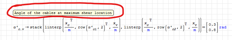

It would be good if SMath offered the functionality of formatting the description region, including: (i) font, (ii) background (yellow is cool, but not always applicable), (iii) frame/boundary (on/off).

You lost me there. Are you saying it is possible to change the colour of description background (see below) from the default yellow?

Thanks Jean. I think we misunderstood each other. I was proposing to change the background of the description region/field, rather than the input region, as your example shows. Something like this:
This is not possible.
In fact, I asked for this 10 years ago.
Alteration of descriptions not implemented since.
Text regions doesn't have description too.
Asked for this also, no change so far.
Long word short, don't rise your expectations.

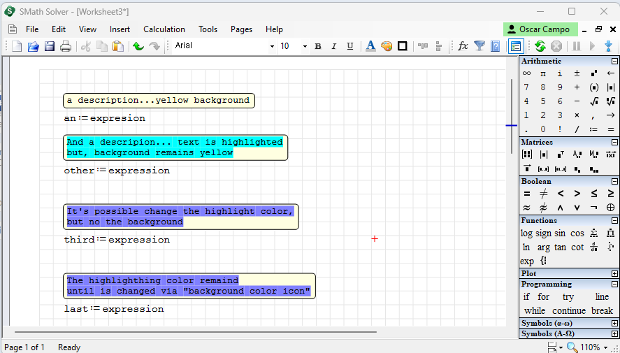

135 likes in 309 posts.
It's not possible change the background color of description region.
Only it's possible change the color which the text is highlighted inside a description region.
Please see this video:
best,
Oscar

600 likes in 1,381 posts.
This is not persistent. Possibly just a visual bug.
Background color changes to description text is not saved.
I checked with an external text editor, no data saved related to it.
They are same with yellow background and colorful highlighted.
When you save file, close it and reopen it all colors will revert.
Either to latest selected background or yellow.

Oscar Campo
Oscar Campo
It is a very strange behavior...
But, before I posted, I did that check you mention. I saved the file, then closed SMath, reopened, and the colors remain...
#14 Posted: 9/20/2023 11:23:01 AM
Close smath, reopen with a blank page, change background color to white, close file without saving.
Now reopen smath with the file you saved, background highlight should be gone.
Oscar Campo 9/20/2023 11:37:00 AM
#15 Posted: 9/20/2023 11:37:53 AM
Oscar Campo
Oscar Campo
Yep..
you're right...
it's only a bug
Thanks!!

Previusly reported here. No change in the background of description region, only the text is highlighted, but is not permanent, was checked as a bug here
