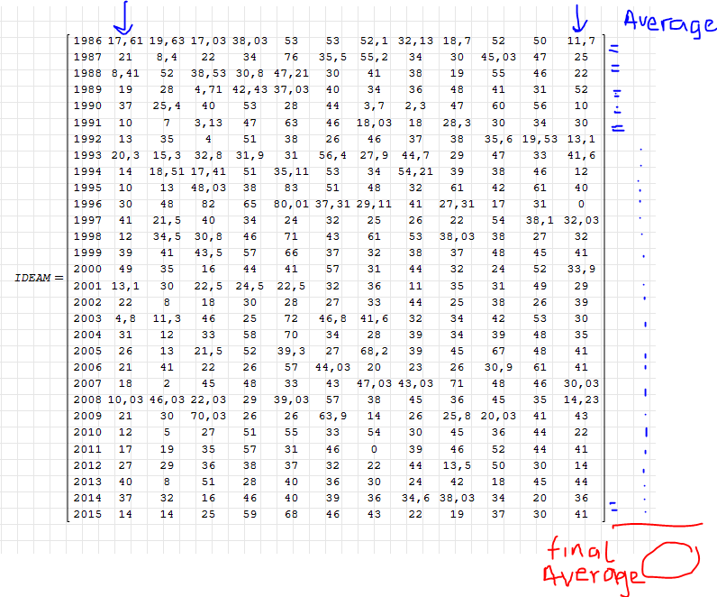

hi...I need find the average of each row (without include the first number) and at the end find the average of all averages....thanks for the help

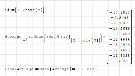

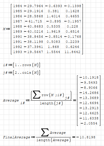

#4 Posted: 6/18/2021 8:02:29 AM
Had you attached the table ... job done.
Average.sm (9.28 KiB) downloaded 1251 time(s).

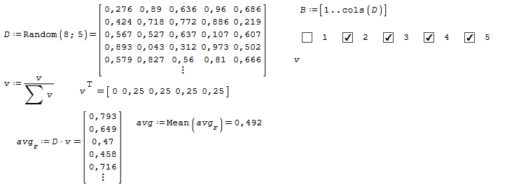

Another version with scalar product.
Easy to adjust to arbitrary subsets of columns.
avg.sm (6.53 KiB) downloaded 1271 time(s).
