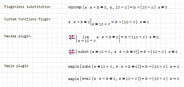

How to make this in Smath:
Mathcad Prime approach:
How is it done this in Smath?
#2 Posted: 10/4/2024 7:38:18 PM
1,555 likes in 1,867 posts.
maple-subs.sm (2.94 KiB) downloaded 1511 time(s).
Links:
1. Maple Tools
2. substitute subexpressions into an expression (maplesoft support)

#4 Posted: 10/5/2024 12:34:45 AM
1,125 likes in 1,798 posts.
subs.sm (9.76 KiB) downloaded 1520 time(s).
