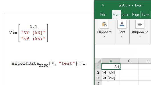

Please check if there is a new version of XlsxImportExport for your SMath Studio version.

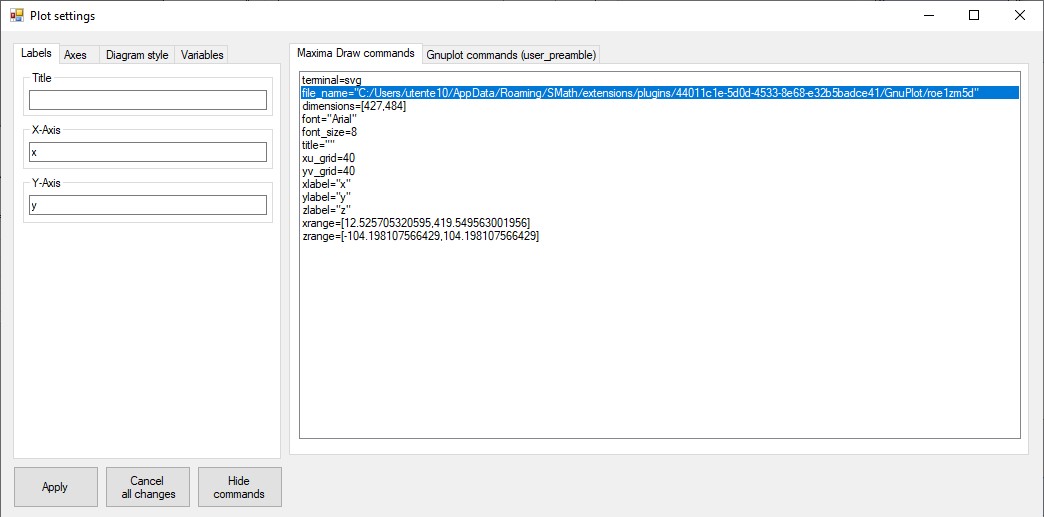

I'm not sure, it's a spreadsheet made by a friend of mine. It's the one that allows Maxima Draw commands and Gnuplot commands in the settings, if could help...

#8 Posted: 1/11/2022 1:45:11 PM
1,436 likes in 2,915 posts.
It is the plot from Maxima Plugin. I'll see if I can fix it in the next days.
