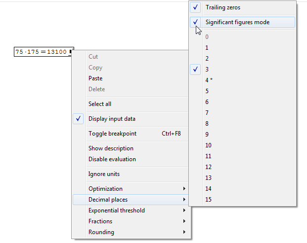

I'm new user on SMath and my Engish is poor. SMath likes me but I don't see how to adjust (in properties) calculation precision. My question is: why programm calculate eg. 75 x 175 = 13100, not 13125? It's precision only I now, but how to adjust it?

Right click on the expression and uncheck Decimal places->Significan figures mode.
