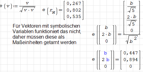

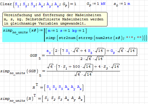

The unit workaround is also useful to enable symbolic simplifications which require the variable to be a scalar (and not a matrix), e.g. determinants and cross products. Not making this assumption in SMath is a design decision, which was explicitly confirmed by Andrey Ivashov, who actually insisted on this behaviour. Another workaround is the use of Maxima, where variables are handled as scalars unless declared otherwise.
The unit camouflage of variables has disadvantages. If you want to establish equations with various variables you will get "units don't match". Also, FindRoot, solve() and roots() won't accept unit names as variable names.
So you need another workaround and your worksheet is becoming very obscure.
Yet while responding to the above post, It comes to my mind that one could try to convert variables to units (with safe names), perform simplification with the str2num-num2str workaround and then convert everything back to the original variable names. I will give this a try but it may get spoiled by non-matching units errors.
Here is an example of a worksheet with extensive usage of units for unknowns.
1-2-Maßeinheiten.sm (152.28 KiB) downloaded 1369 time(s).
