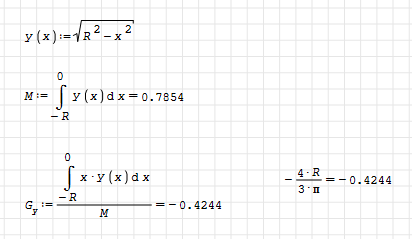

Hi Valery. This could be an option:
Using discrete contours you can see this Martin post.
