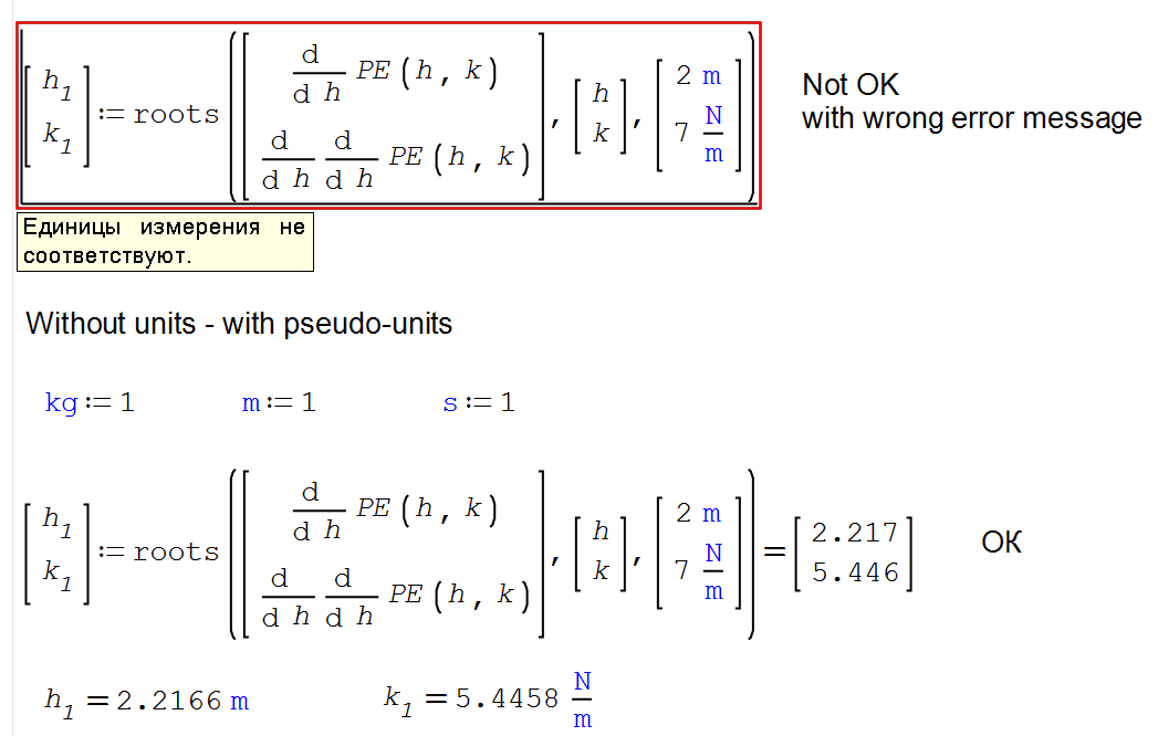

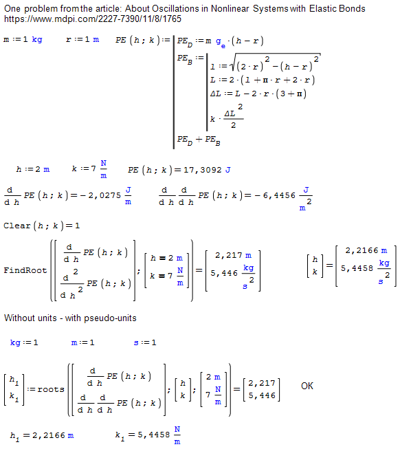

Can Roots and Solve functions work with units?
See please the attach!2-4-OOO-Plots-DD.sm (14.94 KiB) downloaded 1398 time(s).

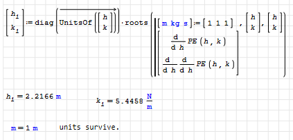

WroteCan Roots and Solve functions work with units?
There are several ways to handle units with SMath roots. This is one of them, where the units are sterilized (Pompelmo' dixit) locally, instead of globally.
2-4-OOO-Plots-DD.sm (12.96 KiB) downloaded 1358 time(s).

Thank you, but this is very difficult for me.
The question was simple: Roots & Units.

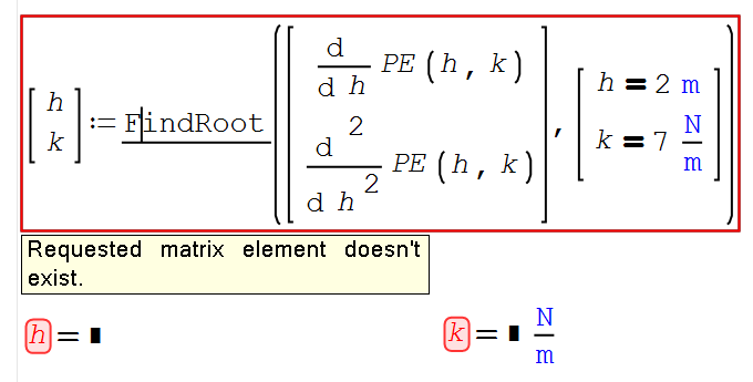

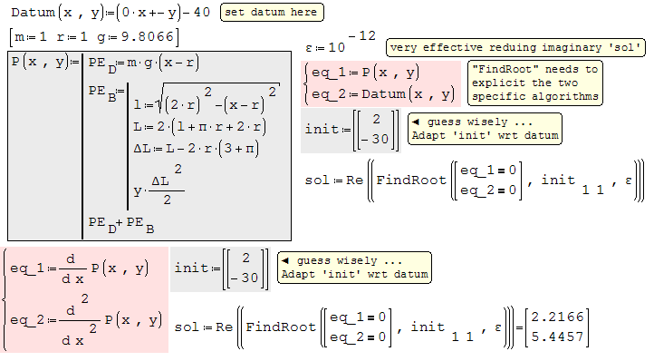

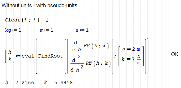

#7 Posted: 5/19/2023 8:08:52 PM
It is simple, if you use Findroot()
2-4-OOO-Plots-DD_Kr.sm (16.37 KiB) downloaded 1360 time(s).
