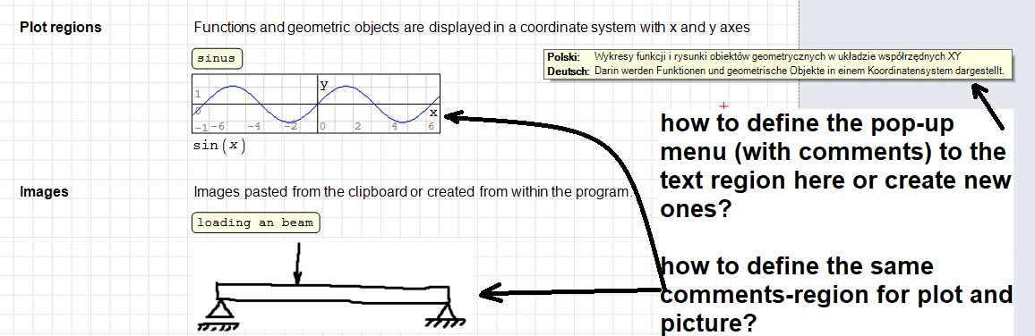

Dear SMath-user and developers,
I have a question regarding a commenst in pop-up, if one with mouse selects a text-region.
Please see you a screenshot hier below.
Best regards,
Andrey

If I understand correctly, you are referring to pop-up with multilanguage text.
That is only available for text regions, which might be translated into different language.
Same feature is not available for other objects (images, graphs) which cannot be translated

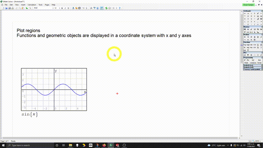

Maybe this can help you:

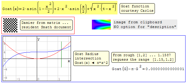

#7 Posted: 9/17/2021 10:13:03 AM
That's my understanding.
