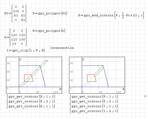

In regards to hatch and fill - do we have a Smath code that can hatch a closed polygon?

#31 Posted: 3/29/2017 8:59:12 AM
Hello Alex,
We don't have it yet for the closed polygon.
We can fill "Stem style" and "Radial stem" [pie chart RemToDo].
If you have a polygon from foreign image: you must first digitize
to get a set of coordinates then fill "Stem style". If your polygon
depends upon some line junction: just a matter of discretizing
within the conditional junctions and plot "Stem style".

#33 Posted: 3/29/2017 9:58:50 AM
1,359 likes in 2,273 posts.
Try the gpc wrapper plugin by davide
GPC.sm (6.8 KiB) downloaded 1810 time(s).
