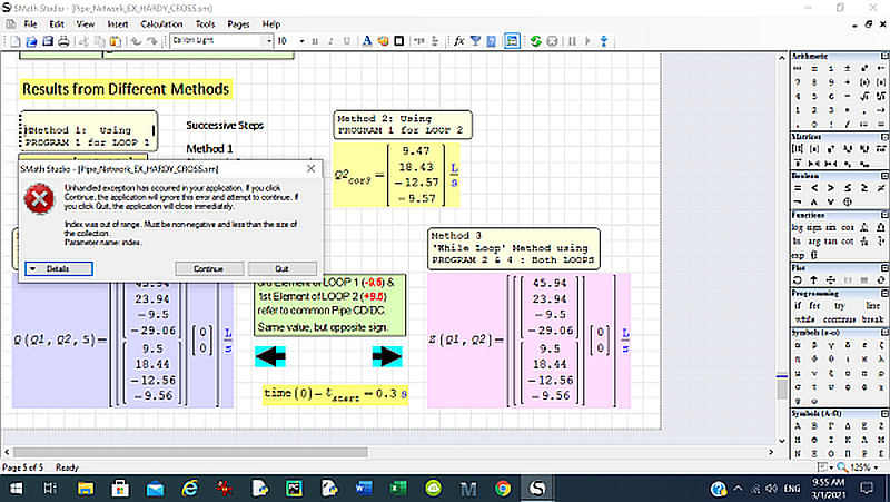

Whenever I try to edit contents of some description boxes the unhandled exception error message props up. For information of Developers please.
#8 Posted: 3/1/2021 7:41:53 AM
Please attache the content of the "Details" window.
Details Window.txt (30.14 KiB) downloaded 1254 time(s).
Pipe_Network_EX_HARDY_CROSS.sm (299.12 KiB) downloaded 1548 time(s).
#10 Posted: 3/4/2021 8:53:47 AM
2,343 likes in 4,055 posts.
Both issues fixed. Thank you!
