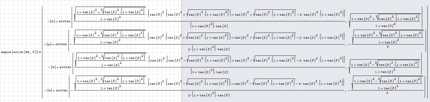

Used symbolic engine (Maple 6) does not always produce the same result. This is normal.
As far as I understand, no solution has been found. These large expressions are equivalent to the original equation. If the solutions are simplified, they will come down to him. Wolfram Alpha could not get an answer.
It is possible to manually simplify the solution and the result may be strange.
#3 Posted: 5/17/2023 7:14:01 AM
Wrote... Wolfram Alpha could not get an answer. ...
Great. Your maple plugin can. Just do sanity check for ensure that do not introduce false solutions.
maple-solve.sm (27.34 KiB) downloaded 1387 time(s).

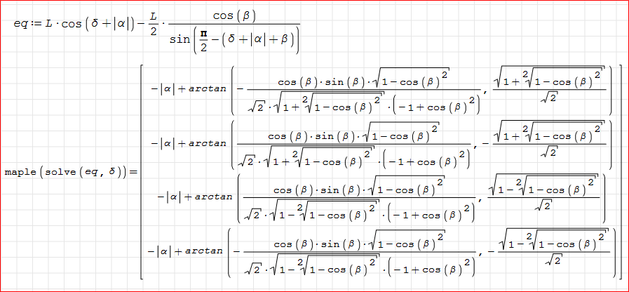

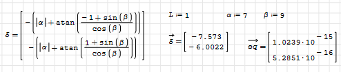

#4 Posted: 5/17/2023 10:21:29 AM
Greetings,
The simple answer is: copy the result from fig.1 and paste it into SMath as its own independent equation.
There is another good reason for this (besides to prevent it from reworking the equation): Runtime
You already solved the equation in terms of 'δ'; no need to waste time and recourses to just solve the exact same equation 'eq' to be in terms of 'δ' every time.
May this be of Good Help,
⚜ Kenny Lemens, P.E. ᵂᴵ
Wrotehow can i have result fig.1?
