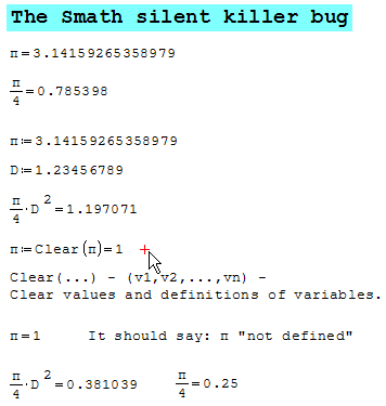

#4 Posted: 3/31/2016 10:22:27 PM
Please don't reply: do this, do that
Smath does NOT do first, I don't have to do what it should do.
Davide Carpi 4/1/2016 6:48:00 PM

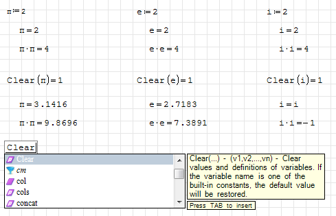

#6 Posted: 4/1/2016 6:56:42 PM
Jean, thank you for pointing out the different behavior of Clear about built-in constants. My fault, was in my knowledge and I've forget to document it.
I've updated the plugin (SS 0.97.5346 and later), now the description of Clear(...) reflects also this behavior.
Fixed in Stable SMath Studio 0.98.5935.
Thank you.
Once again, thank you very much Andrey.
