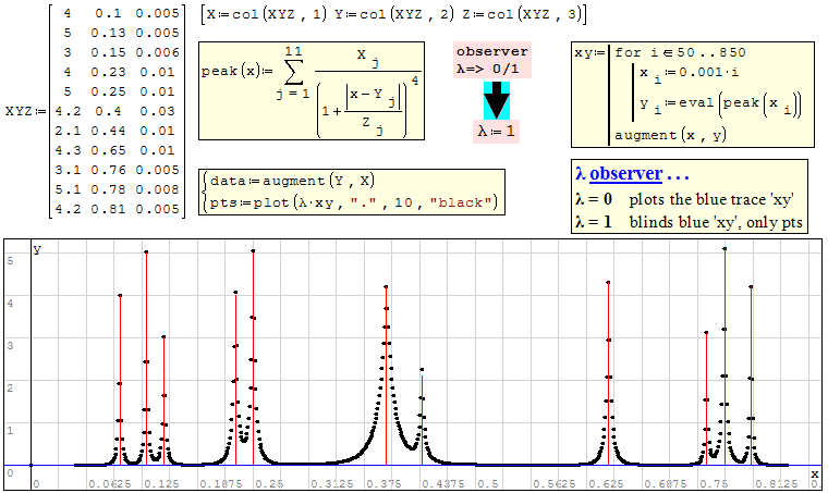

As soon as suggested, Mathsoft obtained permission to code Spline2XV6.
The Mathsoft Team designed this PeakGen for testing their new coding.
At the time, I added some noise and recovered the clean PeakGen.
Spline2XV6 outputs the recovered fit 2000 values.
Here, just an interesting visit, suggestive of creating you own PeakGen
