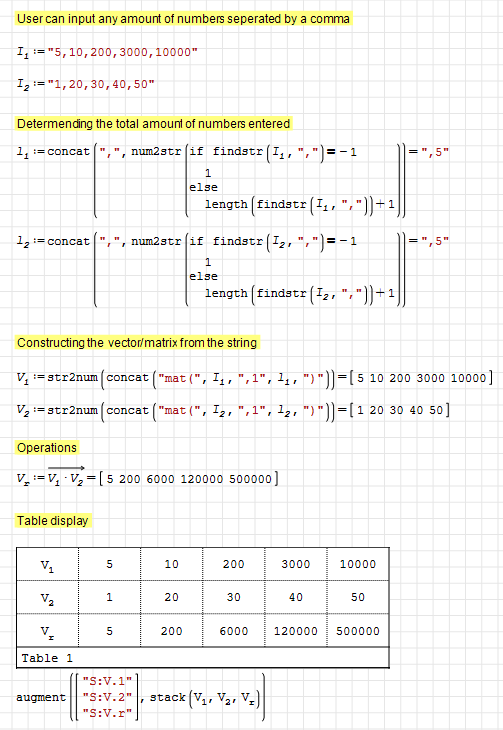

#3 Posted: 3/5/2021 3:01:06 PM
This seems to work for worksheet (.sm) form, but no luck with "SMath Viewer".
It basically builds a multi-element vector from a single string entry.
It works in the viewer, but you can't change the input string in any way.
Maybe the str2num is not supported by the Viewer?

#4 Posted: 3/5/2021 6:01:24 PM
So after doing some digging on the forum I have found that in older versions (97.5737) the modification of text strings was fully functional. For some reason it was disabled, I really can't see why this was done as it solves the major issue of standalone data entry that Smath Viewer has.
Related Topic
Some feedback form the SMath Gods would be nice...
I made an exe that does the same as my previous post, and it works as I intended, not all the same features are available in 97.5737, but as a proof of concept it worked. I was able to enter data into one input box a string with comma separators and then use that data in operations within the exe. I was then able to change the data by editing the input into the input box.
Variable Vector Input Test (97.5737).exe.zip (378 KiB) downloaded 52 time(s).
You can enter two vectors containing equal number of elements, change the length, numbers, and if works just fine!
No table region in 97.5737, so just deal with the string output, but you get the point.

#8 Posted: 3/8/2021 9:51:19 AM
[USERLINK]Andrey Ivashov[/USERLINK], can you give any feedback as to why string modification within the Viewer is not working in recent versions? Note that it was working in 97.5737.
Thanks so much!
Thanks so much!
#9 Posted: 3/9/2021 10:02:04 AM
Andrey made corrections. The update will be available today or tomorrow.
#10 Posted: 3/9/2021 10:53:28 AM
Great to hear. I was certain that it was a minor bug, seemed very trivial.
Thanks so much!
Thanks so much!
#11 Posted: 3/11/2021 3:03:51 AM
Fixed in yesterdays nightly build.
Thank you!
Thank you!
#12 Posted: 3/11/2021 3:39:17 PM
Andrey, Thanks for the fix. I have tested it and it is working perfectly.
