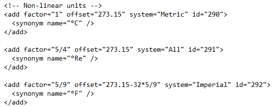

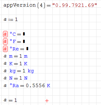

Very strange, seems to be °C, °F, and °Re.
Interestedly enough, these are the units labeled in the units.xml file as nonlinear. I don't know what any of this means, but I'm sure it has something to do with the built in functions that get us these three units.
Oscar Campo 9/16/2021 4:17:00 PM

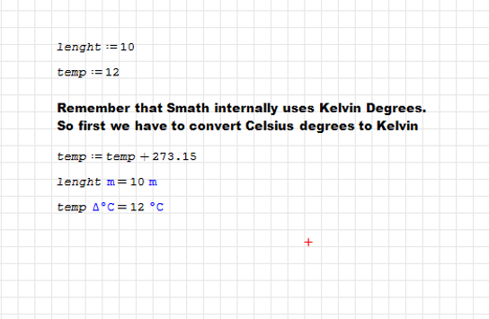

Hello
I think the following can be done
Oscar Campo 9/16/2021 6:16:00 PM, Porschaka 9/17/2021 8:06:00 AM
