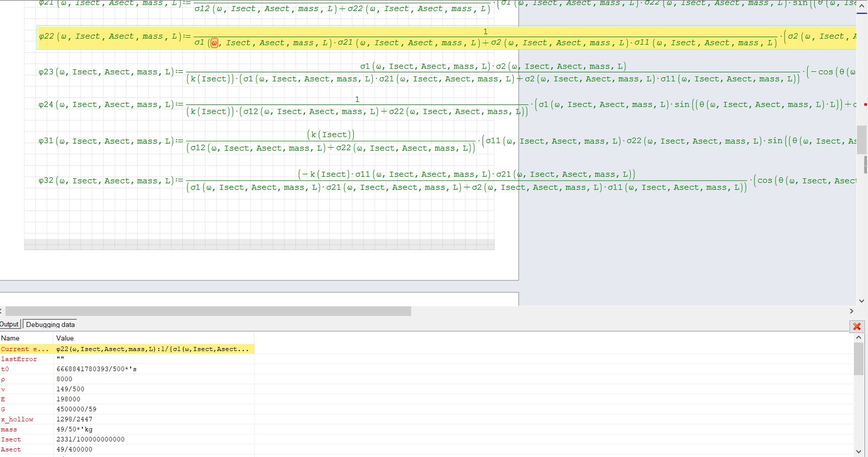

It complains from the very beginning D,d not defined

I discovered in the meanwhile some flaws that I corrected: I can confirm no "complains" now.
BUT after more than 3h, SMath is stuck on detZ function....
What I ask you is to try to run the "modified version" here attached...Please stop
calculation after 1h running, particularly if, in this timeframe, the roots have not been calculated
