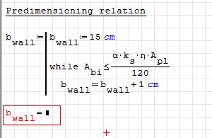

this might be a stupid question, but here it goes:
i am trying to increment a value while a given expression is false.
used to just saying something like i++ for that, but i don't know the language sMath is based on.
i am getting an error :"output value must be defined for the called procedure"
the example is attached.
ty for you're help.

Hi, this discussion about "local variables and functions" might be of help
http://en.smath.info/forum/yaf_postsm5930_Functions-behave-differently-in-0-9.aspx#post5930
Edit:
just put b.wall after the while loop
