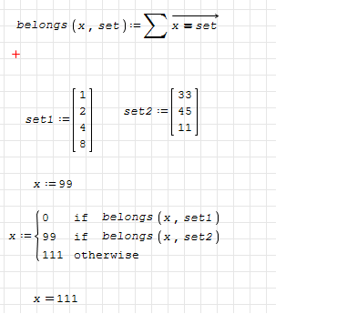

I have the question like this:
Is it possible to obtain a result depending on whether the variable belongs to the collection?
I mean the construction:
if x "belongs to" {1, 2, 4, 8} then x=0 else x=111
or even
if x "belongs to" {1, 2, 4, 8} else if x "belongs to {33, 45, 11) then x=99 else x=111
Thanks for an any response.
Jadalbert
#2 Posted: 7/12/2019 9:27:29 AM
Arie
Arie
94 likes in 285 posts.
Perhaps something like this?
elementsbelongs.sm (4.51 KiB) downloaded 975 time(s).

Thank You both for help. I tested both example and it works. But I dont understand how can I add new line to method (function) cases()? If it is the function cases(), may be I'm wrong. I mean:
x := {1 if ...; 2 otherwise
#5 Posted: 7/13/2019 7:29:29 PM
But I don't understand how can I add new line to method (function) cases()?
... like this
once you have if/otherwise [Cases], click right hand most place holder,
coma twice for one more if... again coma twice like before, DIY.
Cheers.
... like this
Cheers.
Ok, it works. But, I must use SEMICOLON twice. May be it is the same as coma (or comma) in real english. Im from Poland and my English is from school.
Anyway - thank You for help.
Jadalbert
#7 Posted: 7/15/2019 8:41:38 AM
1,443 likes in 2,935 posts.
That's because the more correct answer about arguments or decimal separators would be "press your argument separator" or "press your decimal separtor", since you can customize them in Tools > Options
