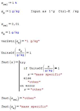

You might use an undefined custom unit 'g/kg for mass specific humidity. This gets carried on because SMath has no idea what to do with it.
unittest.sm (5.92 KiB) downloaded 1208 time(s).
frapuano 4/3/2018 5:29:00 PM

I would like to create a wrapper function for some CoolProp functions and use different parameters according to the unit of the input variable (if the relative or mass-specific air humidity was entered):

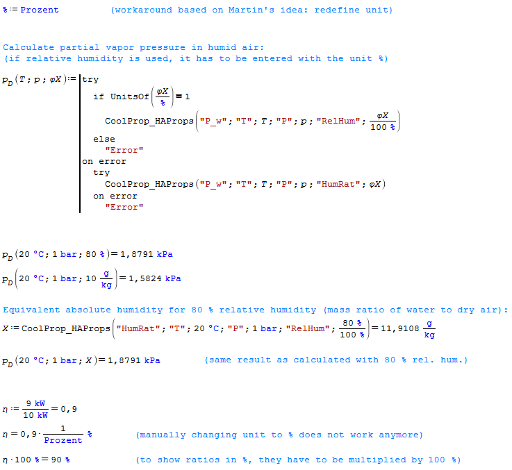

Thank you for the information and thanks for the workaround idea, Martin.
I decided to redefine the percent unit so that I can easier enter the g/kg ratio. The disavantages are that I have to use the unit % for relative humidity and that I cannot convert other ratios or efficiencies directly into percentages, but have to do it manually by multiplying it with 100 % (which is okay for me):

I would be very cautious with re-definition of built-in units. This increases the chance for your document to be misunderstood (including by yourself).
What was the disadvantage of defining a custom unit "g/kg"?
