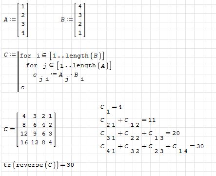

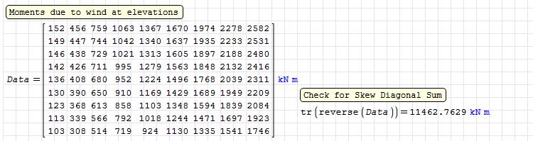

Is there a built in function that can get the sum of the upper secondary diagonals of a matrix? some times called the skew:
I can call each by its element, but I would like it to work for any a1n & an1, I can do tr(reverse) to find the secondary diagonal, after each reduction of the matrix by 1 row/column:

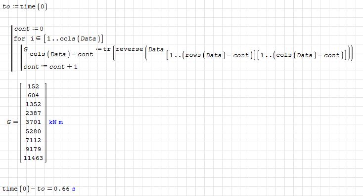

#2 Posted: 12/2/2021 3:23:54 PM
Lets say the matrix is 10 x 10, I don't want the user to have to "manually" create all the steps to get to the tr(reverse), this is a lot of work and could introduce errors. What I want is a simple (if it is indeed simple!) loop to do it.
Your solutions certainly speed up the process and wonder if they could be implemented?
Ian

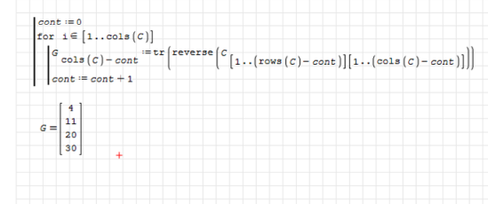

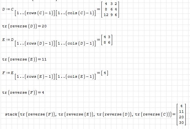

#3 Posted: 12/2/2021 5:33:19 PM
#4 Posted: 12/2/2021 5:42:55 PM
(the first is more a "proof of concept", is very inefficient because it does a lot useless calculations)

Hi Jean,
The image was just to illustrate the direction of the summation, the primary diagonal is top left to bottom right.

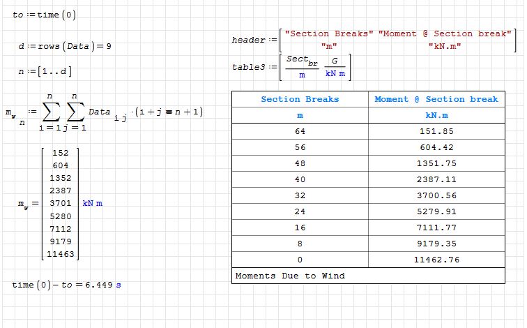

#6 Posted: 12/3/2021 6:53:44 AM
#7 Posted: 12/3/2021 8:06:03 AM

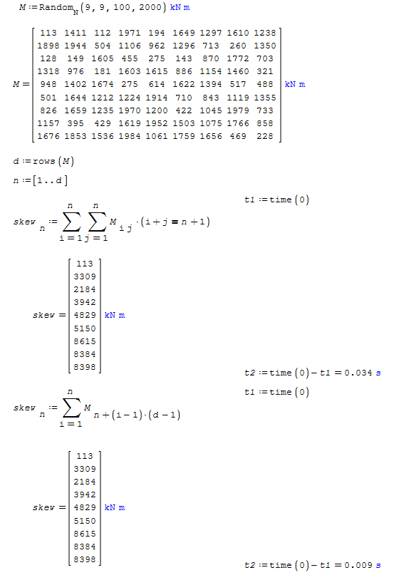

Wrote(the first is more a "proof of concept", is very inefficient because it does a lot useless calculations)
You should try the 2nd method in my file.
As stated in the previous post the first method is really inefficient, since for each iteration it calculates all the sums from the first value up to the n-th diagonal.
BTW with a random set of values and small matrices, doesn't seems so slow in my machine (WIN7PRO/AMD PRO A10/16GB RAM). With bigger matrices the difference is huge (for a 100x100 matrix, 26.1s with first method, 0.028s with second method)
![2021-12-03 13_23_51-SMath Solver - [skew.sm_].png](/en-US/files/Download/CpRGST/2021-12-03-13_23_51-SMath-Solver---[skew.sm_].png)
The method to check the sum of [r,c] coordinates can be used more efficently in a double loop, though (here it is extended to the whole matrix).
![2021-12-03 12_14_18-SMath Solver - [skew.sm_].png](/en-US/files/Download/4d44dF/2021-12-03-12_14_18-SMath-Solver---[skew.sm_].png)
#8 Posted: 12/3/2021 11:51:14 AM
Second method now as quick as the first by Carlos.
