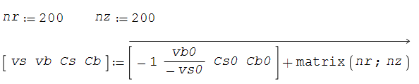

As side note, you might initialize you matrices even like this:

That's what you have in my reply
