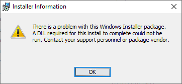

Hi I am having problems to install. I got the message "There is a problem with this windows installer package. A DLL required for this install to complete could not be run. Contact you support personel or package vendor" and when I click in OK button instalation ends without information about what DLL was the problem.
I am running Windows 10 Pro 21H2, compilation 19044.1645
Any hint how to solve?

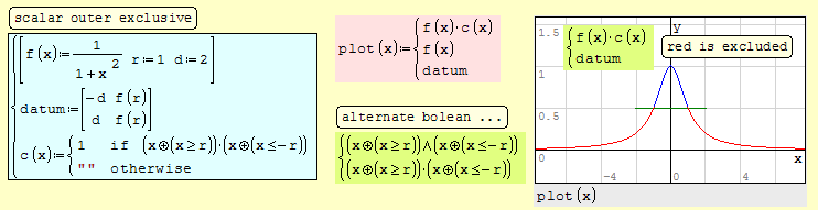

(which was annoying if only if-statement was needed)
IMHO, I have never seen only if as it is not Bolean.
if/else ... if/otherwise are generally not interchangeable.
In program if/else on strictly numeric branching.
if/otherwise is a scalar function for plotting, integrator, solving ...
Cheers ... Jean if you wish more.
#14 Posted: 7/28/2022 11:00:13 AM
Under construction ...
... if/else in program.
... if/otherwise scalar [plot, solve, integration ...]
Good reading ... Jean.
X_Y Bolean EXCLUSIVE...TREASURY.sm (105.5 KiB) downloaded 1904 time(s).

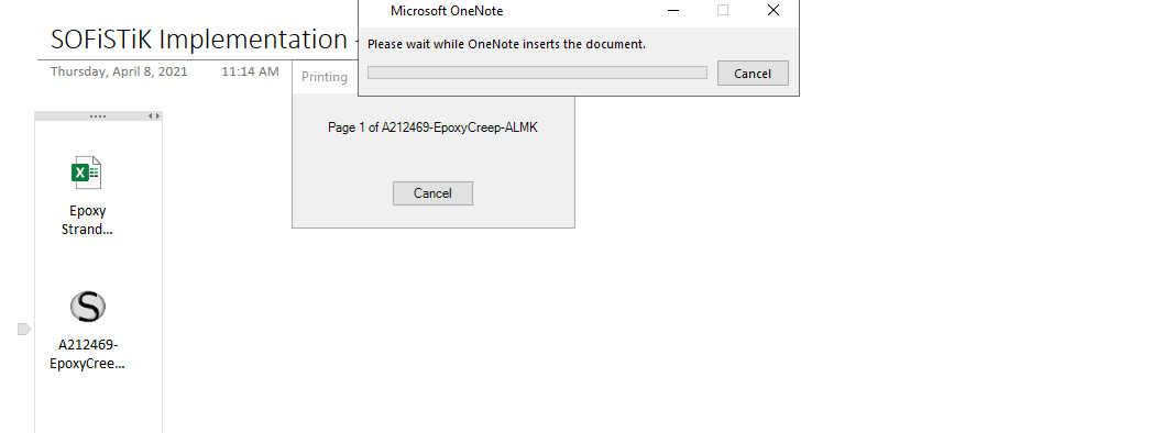

Updating from 1.0.8151 to 1.0.8238 broke background printing of smath document. I used to be able to copy paste the file onto one note page (for collaboration), right click on it and "insert as printout" (see screenshot). This functionality broke down with switch to 1.0.8238. I will stay at 1.0.8151 for now.
Cheers
